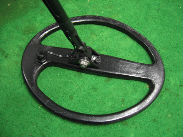

              When making my GoldQuest coils years ago a 1.2 - 1.5 damping resistor was used so this is similar. It was working at 8-9us but it was ringing, the 1.5R calmed everything down. I installed a pot and kept adjusting until she ran smooth. Here is a pic of my Surf PI 13 x 11 coil. This one finished off a little rougher then most but who cares it works great! Coil is formed in 3 pieces the main shell, the ears and then the bottom.
                Well that doesn't look too bad at all!
                So, did you make a "clam shell" with matching top and bottoms parts like Hayes does?
                Mine show imperfections as well, but like you said, as long as it's functional. After all, we are just home builders in the end.
                One thing that helps. When (if) you run out of plastic sheets, get ahold of ABS with a "hair cell" texture. It tends to hide little imperfections as well as scratches that will occur later on. It's the same texture that you can find on White's coils.

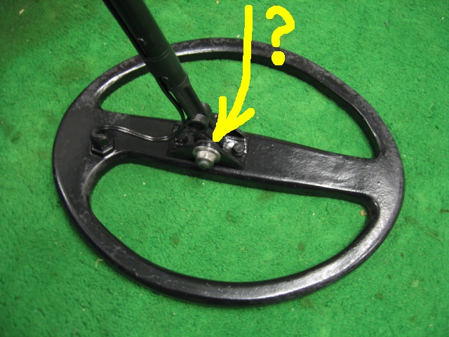

                    Is this a metal bolt connecting the coil to the stem?
                    Also, shouldn't you have used shielded cable?
                      I have been guilty of that.. Stainless steel seems to be OK though. Nautilus detectors come that way!
                        Ok boys lets all calm down.... Nylon nut and bolt is used and cable is shielded, no way it would work as good as it does without it.
                        Bob

                                i have tested the surf pi with a plastic shaft and also aluminium it makes no differnce
                                but decided for plastice because i BELIEVE it is better
