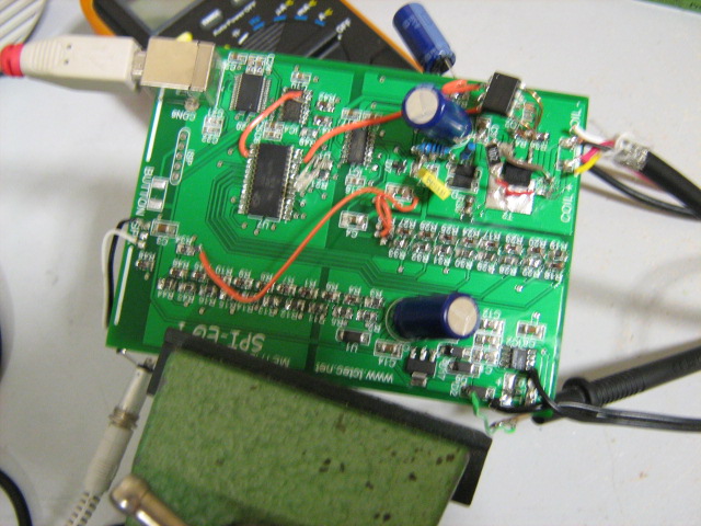

    I have designed a PI detector.
    SPI-EG-1
    It has a USB interface (but doesn't require PC to operate).
    The design is different to most PIs I have seen
    1. There is no pre-amp, or knob to threshold adjust or set gain, ..no conventional OP-amp amplification at all.
    The signal is sampled directly at high resolution through a simple and stable comparator / timing system.
    The signal threshold and amplification is all performed in software.
    (Press a button and software will set the threshold).
    Any part of the discharge curve can be sampled.
    The sample is very narrow (fine)
    The whole curve can be scanned and displayed on a PC (if you wanted to)
    I have built prototype-1
    Coil: 0.5mm wire 25 turns around a 200mm pram wheel, no fine tuning of damping resistor.
    Results:
    Sensitivity: Australian 20c piece - 160mm in air.
    Works well in soil:
    Found: decimal coins $2, 50c, 10c, 2c, copper bracelet, plenty of junk also at range of depths.
    (Test Area is less than 20 years old consisting of a small park, beach including black sand, salt water)
    Was noisy and unusable in wet salty sand..changing coil angles gave a signal.
    I will be assembling the first production PCB next week, and testing 'production version 1' ASAP.

      Hi Jim,
      I have attached the circuit diagram,...
      The main gist of it is: two resistor arrays (DAC) to set a voltage on the comparators.
      One is a timing pulse, the other is the pulse from the coil.
      The pulses out from the comparators clock a flip-flop, the flip flop output is 1 or 0 depending on which pulse is fastest.
      One voltage sets the point on the coil curve to detect.
      The other voltage sets the timing pulse.
      The point at which the coil curve crosses the voltage threshold, is found by adjusting the timing pulse.
      i.e, The time for the coil to discharge to a certain point is timed very accurately.
      The processor is a Cypress PSOC, and the code is written in C.
      The PC interface is just serial commands, so any language can will be able to talk to it.
      There isn't any PC software yet.. (I will start with just a normal spreadsheet, that pulls the data from the detector using a Macro)

          I have built and played around with version 1 ( SPI-EG-1 ), there were plenty of mistakes and things that needed to be fixed and it ended up looking like a messy prototype
          I've learnt alot and made some changes, the most interesting thing I have learn't is how to achieve reliable discrimination between iron and non iron... I think.

              Updated circuit
              Latest circuit. A few changes, shows component values.

                    Improvements - reduce noise, use mosfet driver.
                    Don't use an opto coupler to switch a mosfet.
                    I have replaced the opto-coupler with a mosfet driver.
                    This has improved stability.
                    The opto coupler was causing drift and noise and was also affected by temperature changes (Because the opto coupler is slow to switch and has low current output).
                    Now that the mosfet is being switched by a mosfet driver, the signal is more stable (less low frequency noise and drift).,..because the pulses are now more stable.
                    I threw the opto coupler in the bin.
                    The detector signal is much more stable..added 5 centimetres detection depth to a 20c coin in air.
