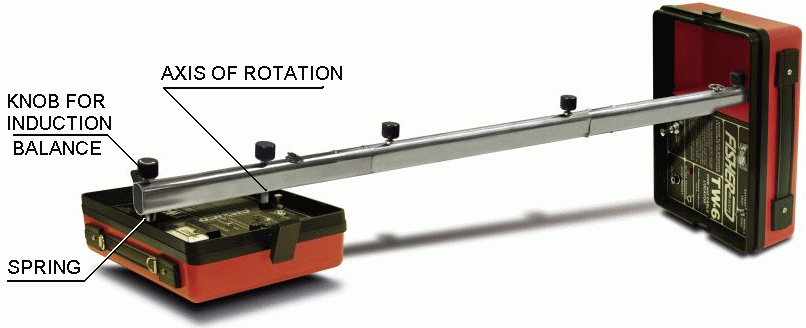

        how does the tuning screw work .will any screw work?
          The screw operates as knob for induction balance.

            is the black rim indicated plastic on the new ones ?

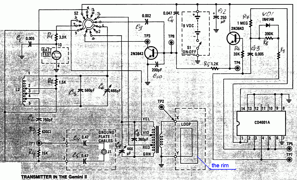

              Taliesin, the rim operates as coil. In your model, the coil has only one turn, connected to circuit by a matching transformer.

                  Here is a circuit of RX box:

                    Fisher Gemini III has not one turn loop as the Gemini II. It has many turns.
                    I believe that TW is the same with Gemini III.
                      Hi Mikebg.

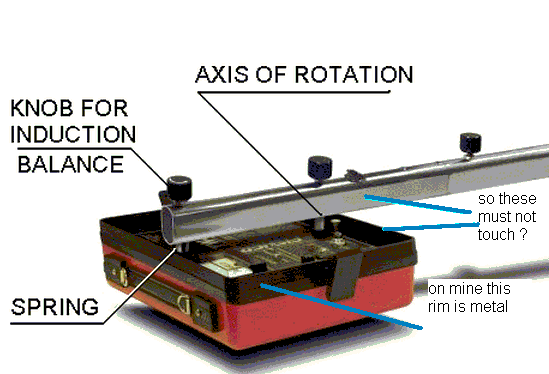

                      Taliesin will tell us. If the rim of TW is made of aluminium, then the loop has only one turn.

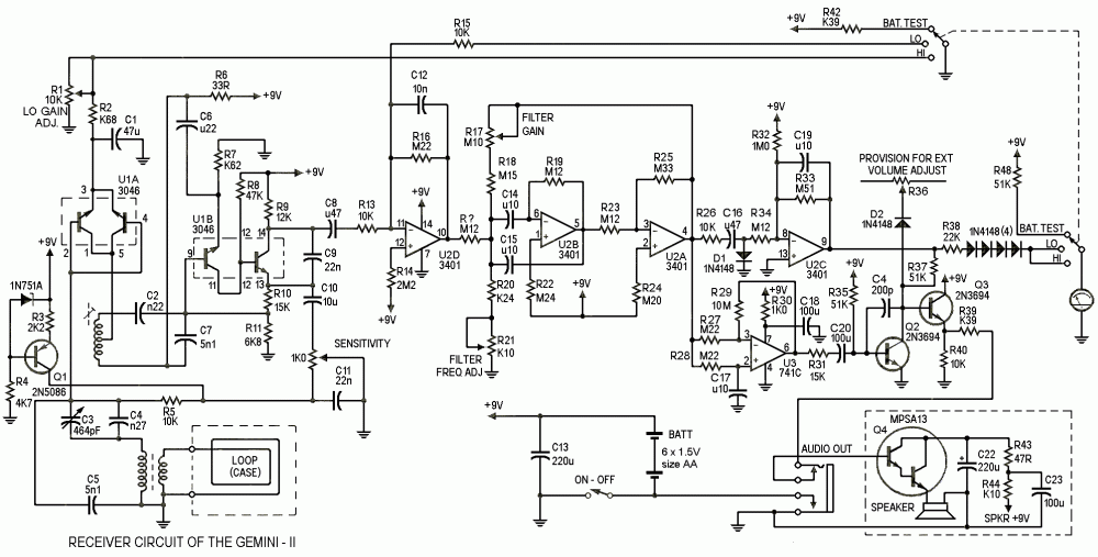

                      Geo, Do you have circuit diagrams of Gemini III?
                        yes the rim is aluminium
                          Sorry... but No.

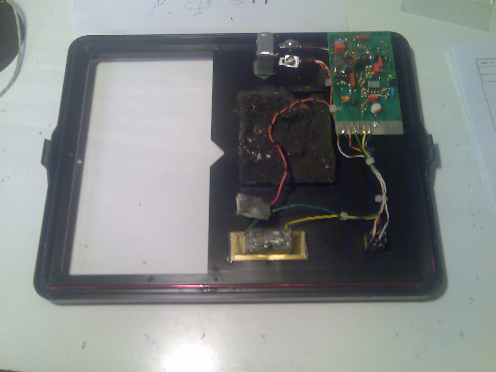

                          I tried to reverse the pcb but i let it at half.... maybe i am a little lazy
