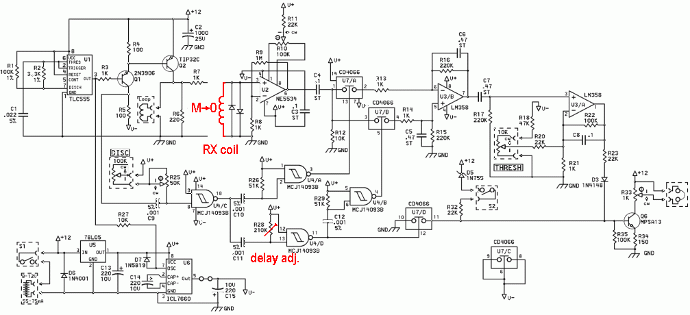

              Maikl, the improvements for Surfmaster are not expensive. As first step try with an induction balanced search head. Then put a trim pot for delay of second sample.
              Hi mikebg. Show directly on the scheme Surfmaster for what you thought.
                  Maikl, sorry for Ratko Mladich :-(
                  In the attached mod diagram should be connected a damping resistor in parallel to RX coil.

                      I believe that in addition to R buffer, should be included R7 1 k, TX. (Perform similar tests on the delta pulse)

                        Sorry, I meant: it should include R7, 1 K, in RX.
                          Hi mikebg. I am very sorry for Ratko Mladić. He is now an old and very sick man...But I have another question which would be the inductance and resistance of the RX coil (TX kept the old values)?

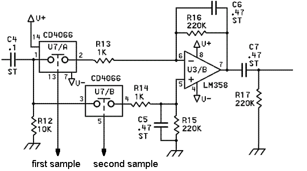

                            Jose, do you know how operates this circuit?
                              Which would be the inductance and resistance of the RX coil (TX kept the old values)?
                              Maikl, for best results we need new value of TX coil. At PI metal detectors, we can not calculate inductances of TX and RX winding because we do not know the equivalent capacitances connected to it. They are shown below as equivalent circuit diagram.
                              We need to determine suitable inductances L1 and L2 experimentally connecting coils with more turns than expected, then test operation of circuit, unwind one turn, again test etc.
                              For the same reason it is necessary to determine experimentally and damping resistances, because they depend on capacitances, inductances and coil resistance (not shown).
                                Hello Mikebg
                                Do not really know how this circuit. I know what function to perform.
                                I have some concepts
                                U7A and U7B are keys that are activated during a time of 50 usec. Approximately at the inverting input and noninverting of U3B.
                                U7A trips after the time called delay time, measured from the end of the TX pulse, this time (minimum) depends on the characteristic of the coil and circuit capacitances, etc. While the control variable "disc of 100 K
                                From this moment, U3B, making the sign of the signal and amplifies it for a time determined by the second shot U7B.
                                This time last 210 usec. Approximately, taking into account the values ​​of R28 and C11.
                                The Delta Pulse, this control variable (second sample) and not notice much difference except more profit but also more noise, if the selected time is great.
                                So my question, if this control has another advantage that I do not know.
                                Thanks for responding and please correct me or clarify my doubts.
