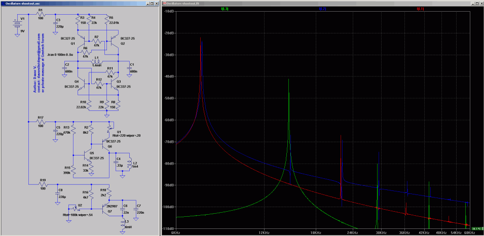

  • I gave this a second thought and made a LTspice sim to compare my vision of a future Tx with the existing ones. From top to bottom are:
    - balanced H-bridge cross-coupled oscillator, draws about 4.5mA, very clean, no 2nd harmonic, works fine without adjustments (look Ma, no hands )
    - Musketeer IGSL, works fine, a bit less current draw, about -40dBc 2nd harmonic, requires adjustment
    - TGSL IGSL, draws very little current, but the coil current is also small, quite touchy, I had to change a resistor between base and positive rail to be able to tune it - perhaps it is the source of a no tuning with TR3 problem, when it oscillates in full rail regime the 2nd harmonic is whooping -30dBc
    The first two use a Musketeer coil with my odd specifications (mine was built that way), and the third one is a TGSL, and it also works on ~double the frequency.
    Lo and behold, but please give me some feedback as well:
