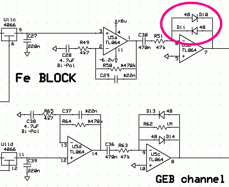

                      • I may have a quick fix for the Fe channel shortcomings in the existing builds that is really dead simple. In fact I already implemented it in my other mods. It is not competing with the other mods or in functioning of the rig.
                        Short explanation...
                        There are GEB and Disc channels. In TGSL schematic both are compared against a Disc. sens. voltage, so that the noise does not pass through in the form of chatter. Fine. But the point is that the Disc channel is merely determining the quadrant signal is coming from, hence the perfect reference is not Disc.Sens. but exactly 0V, and it's ideal mode of operation is binary. As I already noticed the need for better discrimination criterion at low signals, I already pumped up the gain of the second stage of both Disc. channels in my mods, but failed to notice that it also cures the faulty behaviour of the Fe channel in the original build.
                        The comparator pins are swapped in the Fe disc channel and the correct operation would be assured if they are corrected, but this quick fix will improve things a lot, and will also improve discrimination over a whole target distance range.
                        How to do it? Locate the diodes in the gain stages and identify them. Do the same for both Fe and non-Fe channels. Extract the diodes in the first stages, extract the capacitors in the second stages, also extract the 1M resistors in the second stages, place the antiparallel diodes in place of the extracted capacitors (indicated by a circle). Done. Enjoy!
                        So in essence you don't have to swap the comparator pins in Fe Disc channel if you do this mod
                        See picture
