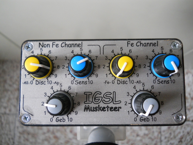

      • Ok, is time to share some picture of my IGSL:
        Coil is home made, handle is from Tesoro Cibola; I hope you like it!

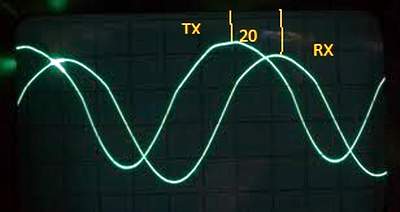

              • Hi all,
                I remade another coil for IGSL and I also made a "phase meter" to check the phase shift of 20 °
                Values ​​finished with shielding coils made ​​in the rules: 6mh TX, RX 6.5 mh
                When I measure the frequency of TX, I 14.12 kHz maximum with TR3 and this check by calculation: F0 = 159 / Racine (6x22) = 13.8khz average
                My question is why is that the diagram indicates TGSL TX 14.6khz?
                For this frequency, I need to change the capacitor C2 20nF ...
                By calculation, an TX coil 5.7mh give 14.6khz with a capacitor C2 of 22NF and in this case, why the diagram shows a coil 6mh??
                What do you think?
                I have another question for those who have set the phase to the oscilloscope:
                My phasemeter does not indicate the positive or negative direction of phase shift and that is very sensitive with respect to "0".
                When the coils are in phase (0), the phase shift of 20° good will by removing the coils or together?
                I'll rephrase my question: when my coils are in phase (coupled +-18mm), I overcoupled or undercoupled from 20°?

                  You are absolutely right.
                  Original Tesoro coil which i used with my first (prototype) IGSL was ~5.7mH.
                  And than i measured frequency and noted 14.6kHz on schematic.
                  Later i assumed that most of people will rather choose to make own coil, 6mH, which is well described in those PDF documents here on forum.
                  My mistake is because i didn't removed "14.6kHz" from schematic where later i added "6mH" for TX. Sorry!
                  So 14.6kHz is NOT THE RULE. You don't need to chase it by any cost.
                  Just set your detector to work good and to meet your expectations, don't mind about exact frequency because IGSL (TGSL) is "tolerant" in wider frequency range.
                  RX phase is 20 degrees right from TX, meaning it is "overcoupled" (if i understood correctly your terms?).
                  Use 2 channels scope to see phase relationship while balancing coils.
                  Yes you can post phasemeter schematic here, why not. It can be added to 2 channel scope and used simultaneously in process of balancing.

                    Anyway, here is pretty ugly and rough "picture" of how phase relationship should look like when observed on scope:
