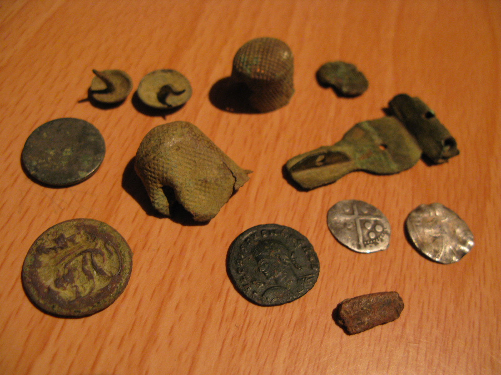

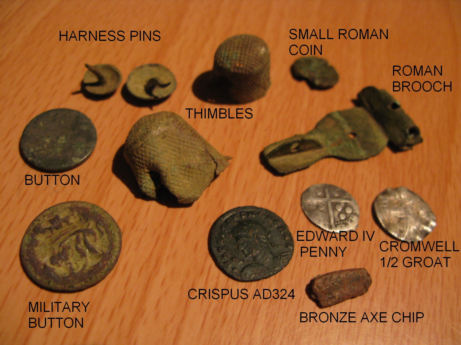

                    recent IDX finds..

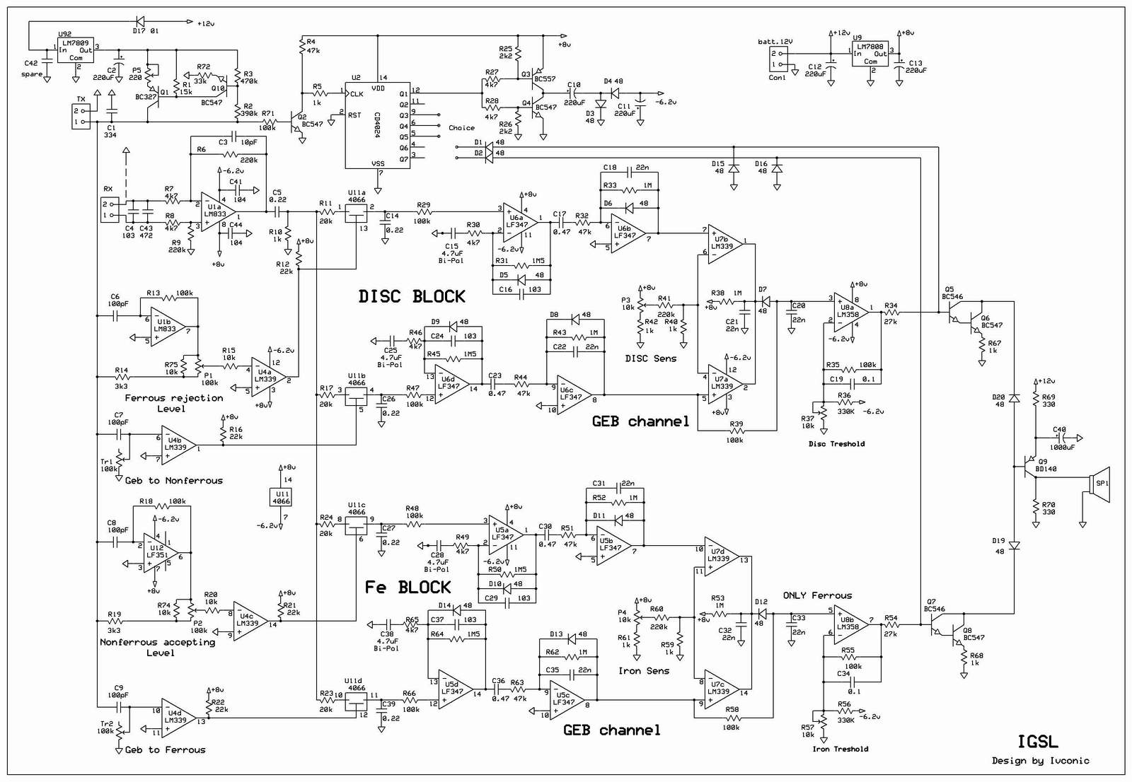

                    • firebok what you can give me kah scema are you doing and networks and all kinds of PCB board components thanks
                      • You can check silverdog's web shop for PCBs.
                        • davor
                          ?Thanks davor for his info davor if you can provide me the layout its FCB.ISGL thanks again
                          • You can find two versions of IGSL. More popular is a version optimised for Musketeer coils. You can build your own coil, as most people did. I also did some mods to make it discriminate iron more accurately, and to make it faster. PCB layout file of this version is attached...
                            • thank you for his help davor but I can not see the zip file types there whether kind pdf or png once again thank davor
                              • Help with .zip files
                                Two of the files purport to be Eagle files ( a good CAD program to use and many years in development. A free full version is always available for Hobbyists to download and use). These two files were not in a true Eagle format according to my Eagle. e.g. unusable.
                                The third is simply a .jpeg of the circuit diagram which I attach.
                                Andy
