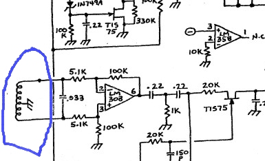

          • Hi Davor,
            I would like to react to your post #1555. You wrote , that you made center tapped coil. I made center tapped Rx coil too, but for Tesoro eldorado. I made center tapped coil by winding of two same paralel wires. Is it correct ? what is advantage of center taped coil ? Can be omitted Rx coil shielding ? what about wet grass ? My Eldorado did not work well. With Eldorado I had problem with discrimination and air detection distance for one euro was only 20 cm.I left this project, so I focused on IGSL ( my air detection distance is same - 20 cm, but discrimination works fine )
            • Centre tapped coil works in differential mode and should be connected to a differential mode preamp. The centre tap goes to signal ground. Eldorado has a preamp similar to IGSL, so you just have to take care about the signal ground. It is indicated as connected to the inverting branch of a preamp in Eldorado, so just take care it is not connected to the coil end, but the coil tap.

              • Davor is this what you did to the Eldorado ?
                • Exactly. Only it was IGSL, but essentially it is the same thing. I'm about to try a combination of 1k5 and 100k in feedback. It is going to increase Rx/Tx angle, but in case of IGSL it seem as a proper course of action, as it will increase Fe discrimination range, and it will improve noise for a few dB. If it works fine I'll introduce it among my other mods.
                  A differential mode coil requires a differential mode input, and a single opamp configured in differential setup has a downside of loading a coil unevenly. Apparently it is not too much of a problem, but a better solution would be a real differential amplifier, or an instrumentation amplifier. The former can be realised with ordinary transistors that exhibit low Rbb and have a very low noise as a result. This solution is cheap in comparison with a real instrumentation amplifier, but also better for our purposes as very low noise instrumentation amps are not too easy to come by.
                  Anyway, If I'm happy with reduced resistors - I'll be pragmatic about it and won't tinker with it any more.
                  For a good example of a differential amplifier in front end see SMW. Sadly one of the inputs is directly connected to the signal ground there, but that would be a way to do it.

                              • Davor
                                have you seen the Centre tapped coil differential front end of this design ?
