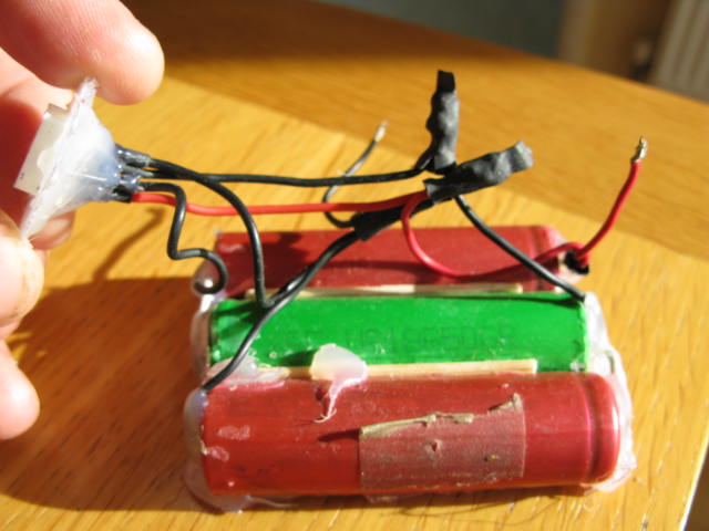

                  • Hello everyone
                    The power IGSL use LION battery that I got off with a laptop (3 cells connected in series), but I do not have a charger for them
                    how to make battery
                    given to any of you has a scheme for making
                    Filling ordinary transformer would kill the battery charger
                    thank you
                    • You need a balanced charger for these, e.g. every battery is charged individually, and therefore the laptop batteries have so many contacts.
                      • You need a balance charger as davor says,
                        Li - cells cannot be charged above 4.2v per cell. You cant simply charge then in series like nicads or NiHh
                        There are cheap china chargers with multiple cell connections.
                        These are inexpensive and effective ...
                        http://www.giantshark.co.uk/product/...alance-charger
                        I use this technique and have used cells from laptop packs - last for ages between charges too.
                        S

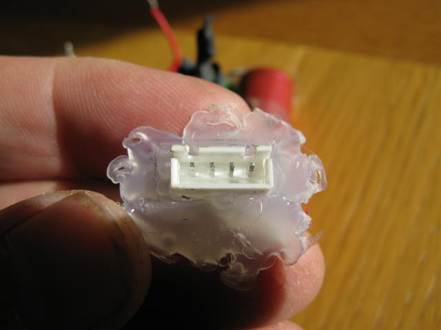

                        • this is one I made up one time I think they were 1800mH its about 12v... best of all free. See your IT guy for an old laptop pack, bust it open- with care. Dont short out as will get exciting. Measure the cells one is normally dead. The others will be ok.Click image for larger version

                          S
                          • Or you can get one of these: https://dx.com/p/portable-6800mah-em...eu-plug-135958 just as I'm about to do myself.

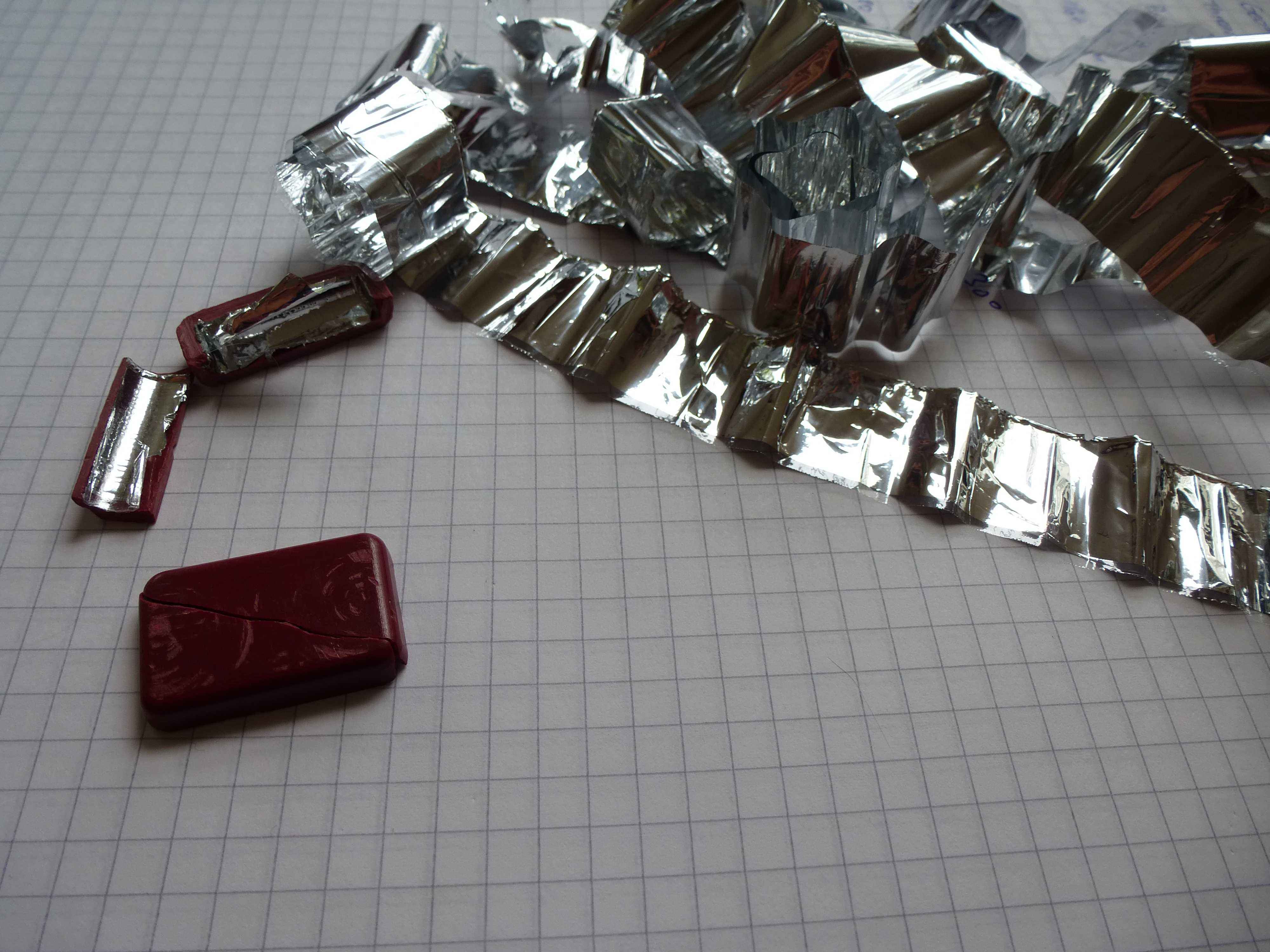

                            • Hello,
                              I want to share some information about the coil shield with you. I have opened a Wima, 1 mikrofarad 250 V bipolar capacitor . I opened it with a saw just along the circumference until the plastic housing material was removed. I opened the capacitor carefully and found the capictor foil partly damaged. I removed the damaged, cut part and had about 2 m of undamaged foil available.
                              The aluminium is metallized on a very thin plastic foil, and is about 2cm in width. When the foil is uncoiled you can observe that it consists of 2 layers (the 2 electrodes of the capacitor). It is possible, to separate those 2 layers again just by pulling, and in the end you have 4 m of foil or more, which is sufficient to shield several coils. When you measure the Al foil, you can see that one side is not conductive (the plastic foil side) and the other side is conductive. I measured a resistance of 50 Ohm for 1 m of foil. The advantage to normal Al foil is that it is much thinner (maybe less intensity loss ?) and that it is much easier to apply this foil compared to Al household foil. It is more like a very thin adhesive tape (without glue). I shielded my coil this way and it was easy to do.
                              didier
