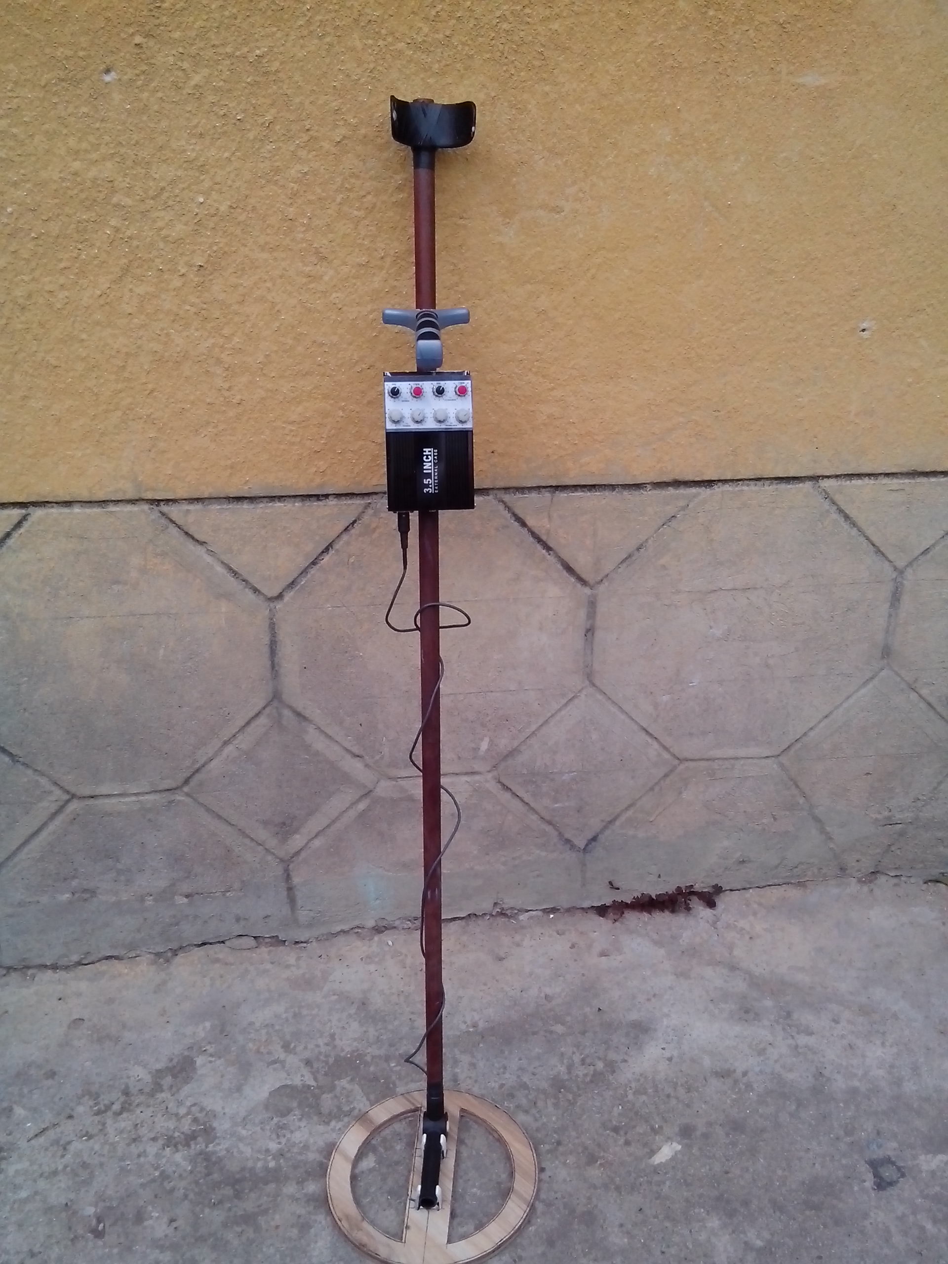

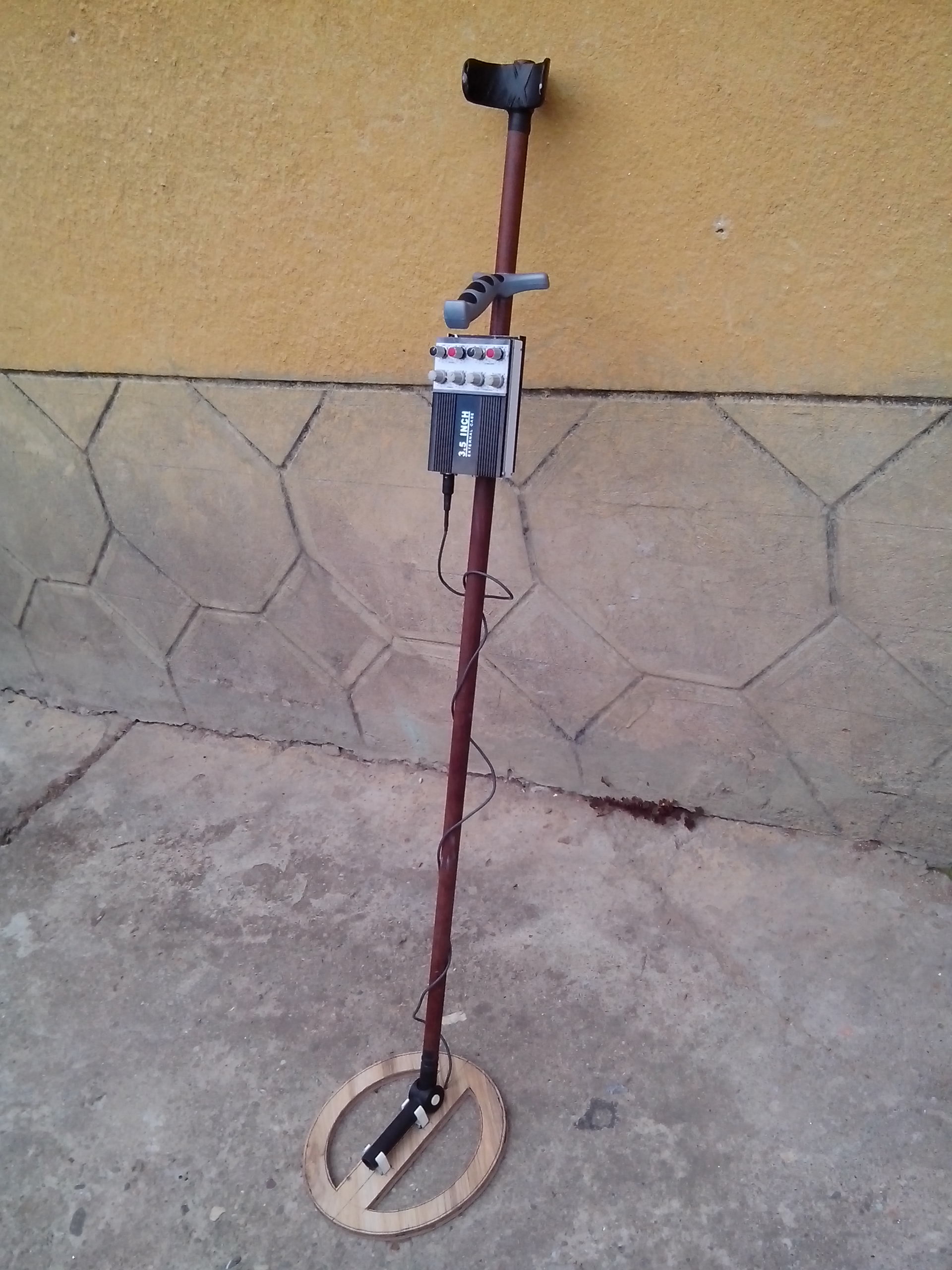

                  I finished 4 days ago IGSL and made TGSL DD probe but the results were average.
                  coins 5e can detect in the air most of the 25-30 cm
                  How can we increase the depth I see that on this forum has a very educated members.
                  I thank you all for your help and answers
                  • thank Liekwang
                    • Labtec try testing in real on the ground I would like to know what you think
                      • just the right handle (bar) to carry the probe and detector.
                        I came up with the idea to use it in an old fishing rod but it is made of carbon fiber and is very easy
                        rinsing is whether the carbon that enters a fault since it is very close to the probe. We know that carbon conducts electricity and it is very dangerous to use when the storm and lightning
                        Your opinion given can be used for IGSL for Delta PiClick image for larger version

                        • I noticed some inconsistencies:
                          if the Tx coil wire 97 rounds 0.25 -6.00 mH Rx coil wire 107 rounds 0.25-6, 50 mH how it could be for Delta Pi coil diameter of 25 cm, 22 to 28 rounds 0.50 wire between 350 and 500 mH as it is written in the topic delta pulse.
                          Maybe I lose something you understand. please help because it is not logical to meno.
