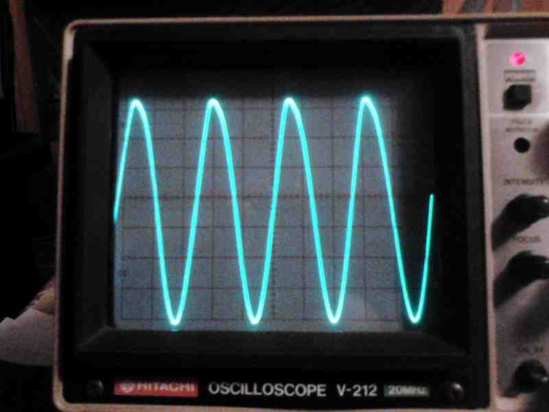

      • Today I was able to visit my "lab" and play a little. Time was short so I picked only one easy thing, a Tx. I wanted to apply the AB->C mod, and it was a success. Unfortunately I was not able to test it deeper in class C so I did not go all the way, but even this far is good.
        This is the output of a regular IGSL Musketeer Tx, very similar to IDX:

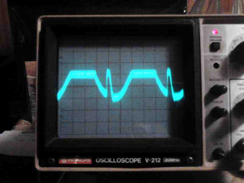

        The most interesting point to observe is the output transistor's emitter because it shows how deeply it goes to saturation, and how much it lags. It is OK for this transistor to go briefly to saturation, but not beyond the supply rail. A good saturation looks like this:

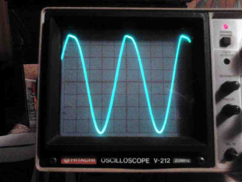

        I (ab)used the negative voltage rail to pull the driver transistor into C class, which is a clever thing to do. When oscillator starts there is no negative rail, so it starts as AB class oscillator. As soon as it starts, a negative rail appears and pulls it down to class C. As a consequence a Tx uses less current, and has improved signal purity. Simulations say over 10dB improvement, but a picture speaks volumes:
Name:	After ABtoC.jpg
        Unfortunately I did not take a CRO shot of the emitter for this one, and I did not go all the way with it. I tested the concept with a very conservative 1M ohm, while somewhat better results would be achieved with 680K as a pull down resistor. 470K is critical, and I didn't want to be without a working IGSL.
        IGSL is a bit less nervous this way. Detection distance is roughly the same. I'd say the most of the chatters are a direct consequence of the Tx misbehaviour.

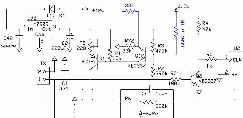

            • The AB->C mod goes like this:
              I did not test the 680k for this purpose, but simulation expects some very nice results because it pulls the oscillator deeper into C class, and conduction angle is such that it reduces both 2nd and 3rd harmonics. I tested only 1Meg.
              For this mod you must put 33k in parallel with the existing one or replace it with 15k.
