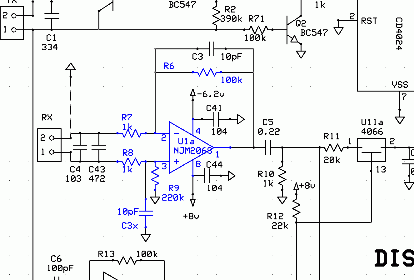

        • Just a short one, I replaced the front-end op amp to NJM2068, and replaced R7/R8 with 1k, and R6/R9 with 100k, I also placed 10pF in parallel with R9. Because of a bit more coil loading the GEB solution is at a slightly higher position of TR2, but works perfectly well. I got a little more depth, maybe about some 3 to 5 cm, but chatters are less pronounced than before. I suspect that NJM2068 is a better performer than LM833 (and also NE5532) in terms of noise and more specifically 1/f noise, and also THD. Due to a strong air signal, every offset fluctuation (1/f noise) gets modulated and later detected as chatters, so both 1/f noise and THD count in a detector performance.

            please, can you mark changes on schematic ? What schematic do you use ?
            Robert
            • Sure I can, only now I'm going out. However, U1, and R6 - R9 are the same on all schematics, Musketeer and TGSL. Even my mods follow original annotations.
              It is preferable to use 1% or better resistors, as this influences CMMR. As I use FKK coils (naked, no shield) with centre tap, a good CMMR is a bonus, and in fact my coil does not pick any "wet grass" chatters.
              • The trip is delayed a little, so here it goes, a quick one:
                • Hi, are you sure, R9 is 220 kohm and R6 100 kohm ? I thought, that R9 and R6 should be the same.
                  I have another problem. When I prospect object, which is very close, I hear double beep. What is wrong ?
                  • Of course they should be the same, it was a quick one and I missed that 220k one More so, these should be as much same as possible because their difference lowers CMMR.
