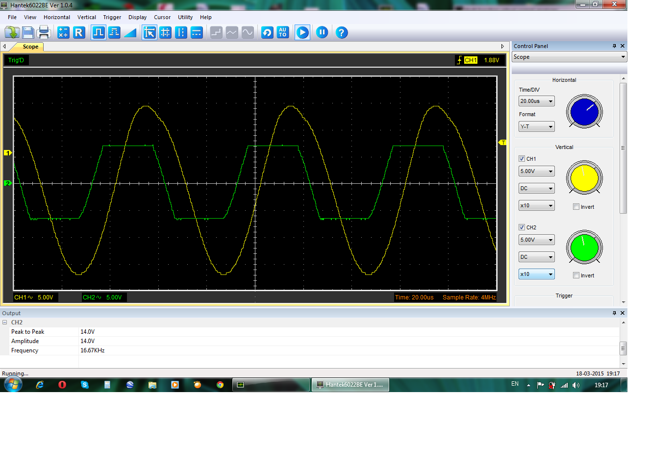

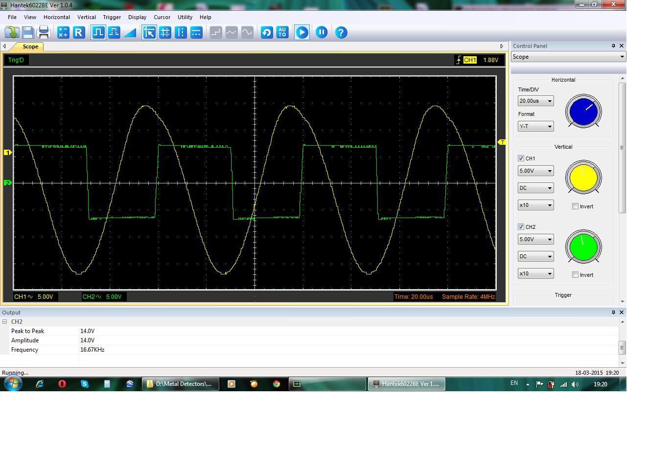

                        • Hi all,
                          This what i did . Generator run 35V p-p , but cant null the coil ,too many noice in the hous minimum Rx voltage is 80-100 mV.On pin 9,10 and 11 of 4053 have signal but on pin 14,15 and 4 have signal only on pin 14 another one is konstant (+5V i am not shure) and nothing on pin 4 .I think first proper tuning coil .R1 is 120 om , I=30.6mA (only generator) ,frequency is 16,9 KHz. this is scheme.IGSL - Copy123.rar
                          • See what you have on pin 1 of LM833
                            • Hi Davor, this is with green Click image for larger version
Name:	LM833 pin 7.png
ID:	342785 pin 7 and pin 1 Click image for larger version
Name:	LM833pin1 (green) to Tx.png
                              • I can explain pin1 with poor coil balance, and pin7 with too much signal at its input. You'll need to reduce it for the phase shifters if you wish to keep that huge Tx voltage.
