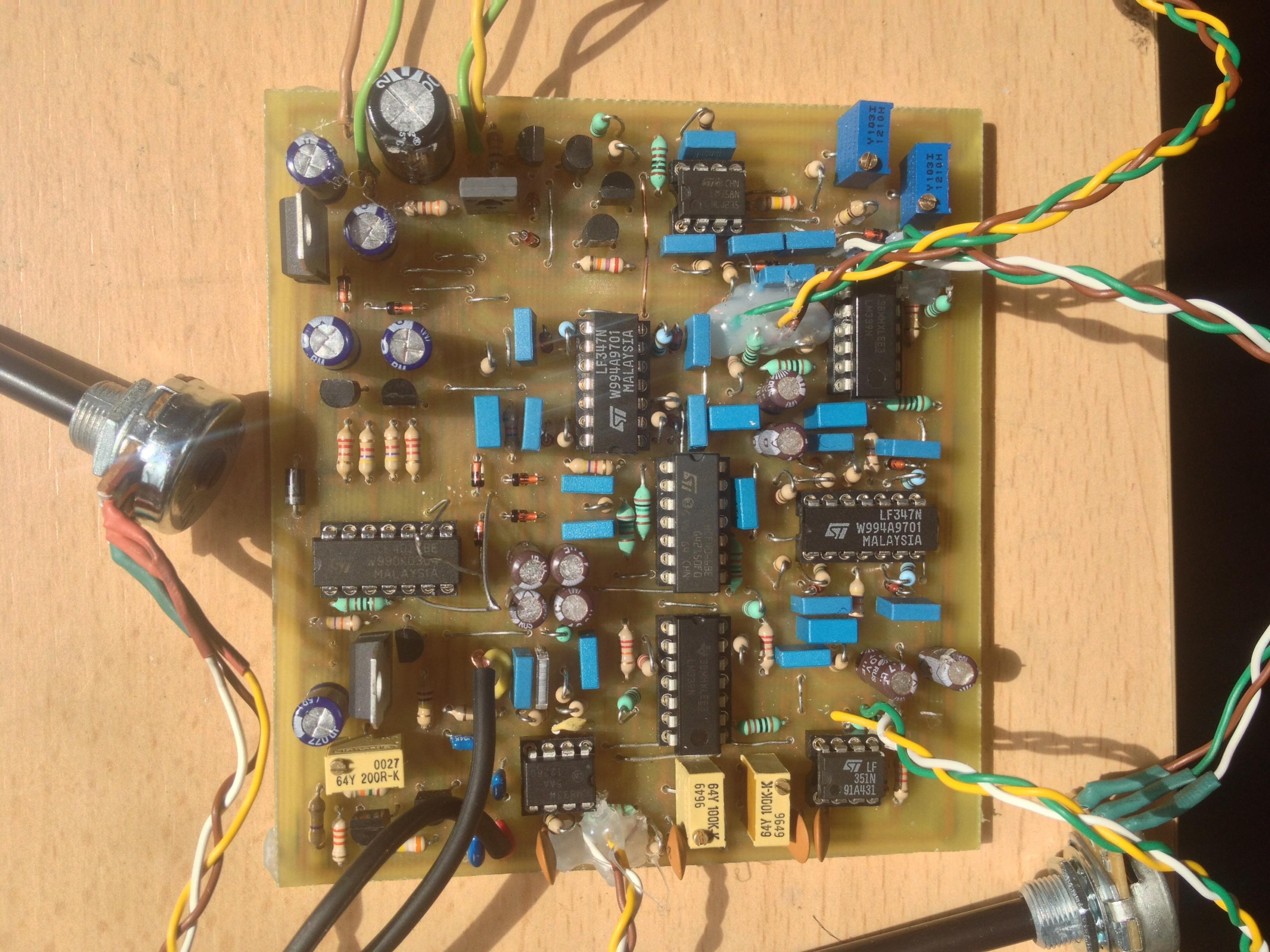

                hello needed help of competent lm 7808 is heated? normal? or do I have any fault in the circuit, the detector detects it works € 1 to 36 sm. 1 mH coil tx, rx 15mH.
                • It can get warm, but not too hot. Good depth
                  • thank you for your reply. I have to shield the coil with graphite spay yet? as will be the best way?
                    • That depends on your coil. You may as well wrap it to aluminium foil, or a ribbon cable. If you use such high-conductivity materials, then you must make sure there are no short circuits against the coil(s). With foil it is achieved with gaps in wrapping. You don't have to leave gaps with graphite, but be warned that graphite is very messy.
                      • thanks for your tips. a greeting
