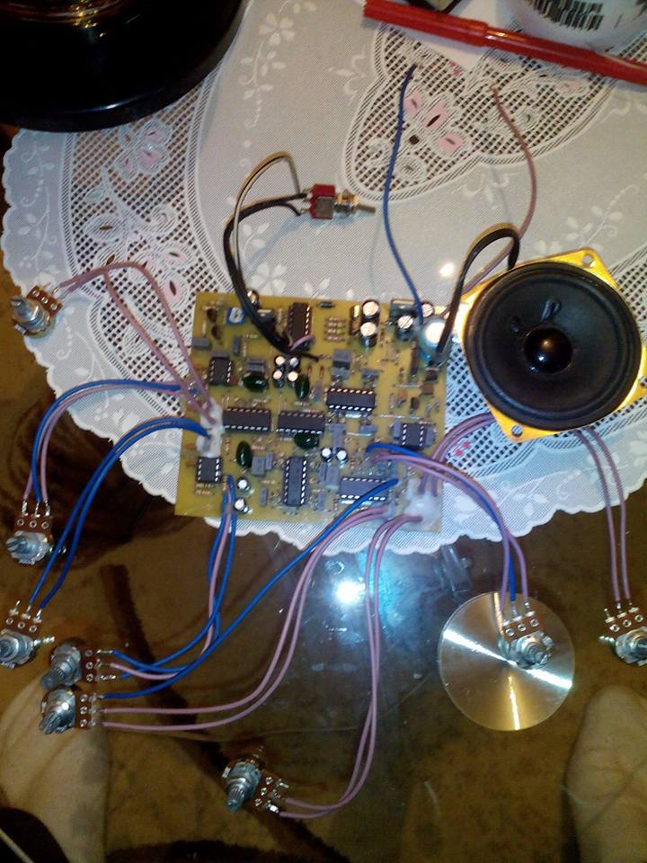

            • Ivica when you turn IGSL with out coil,do you get any sound on speaker??
              this is my igsl
              • Originally posted by seadoggy View Post
                this is my igsl
                [ATTACH]34747[/ATTACH]
                No.
                • hello do IGSL must reject ferrite rod??,
                  my IGSL board working good,but i dont know do must reject ferrite rod when i balance coil.

                      I cant balance coil to remove ferrite!
                      My TX is 1mh-(4.5 ohm)
                      RX-15 mh-(wire 0.20 have 77 ohm)

                        Not all ferrite is made equal. I find a small bit long wave Arial fine but some of the hard emi filters don't reject fully. Also you can have problems if is in a doughnut shape.
                        If you are almost rejecting but running out of adjustment on the ground balance POT I would suspect the phase on the coils is too far out. RX and TX normally have very similar inductance for these detectors.

                          I think my coil is not good(27 cmm coil),i try make new coil i then null coil i see on youtube they can reject ferrit with musketeer coil.
                          I try all night to reject ferrite,but it is mission impossible i have nice deep about 28-30 cmm small gold ring.also i did not shield my coils now i will make new one put shield and then see what will happen.

                              I just measure the running frequency at TX coil i get 9.08 kHz!!,i think it is TX coil problem because i dont have 14.5 kHZ on TX coil and that why i cant remove ferrit rod.
                              • Your coil is Musketeer style, and most probably your IGSL is as well. So 9kHz is OK as well. There might be a problem with Rx resonance being too close if the Rx coil capacitor is too big. Also if you built it strictly according to the original plan, you have 2 channels to adjust ferrite reject. Also please note that some ferrite rods are slightly conductive, and their response is not exactly where it should be. I'm using a small bag with a bunch of square-ish ferrite E-cores for that reason.
                                Now that your device is nearly done, you may wish to seek a pin swap mod that fixes the ferrous channel offset.
