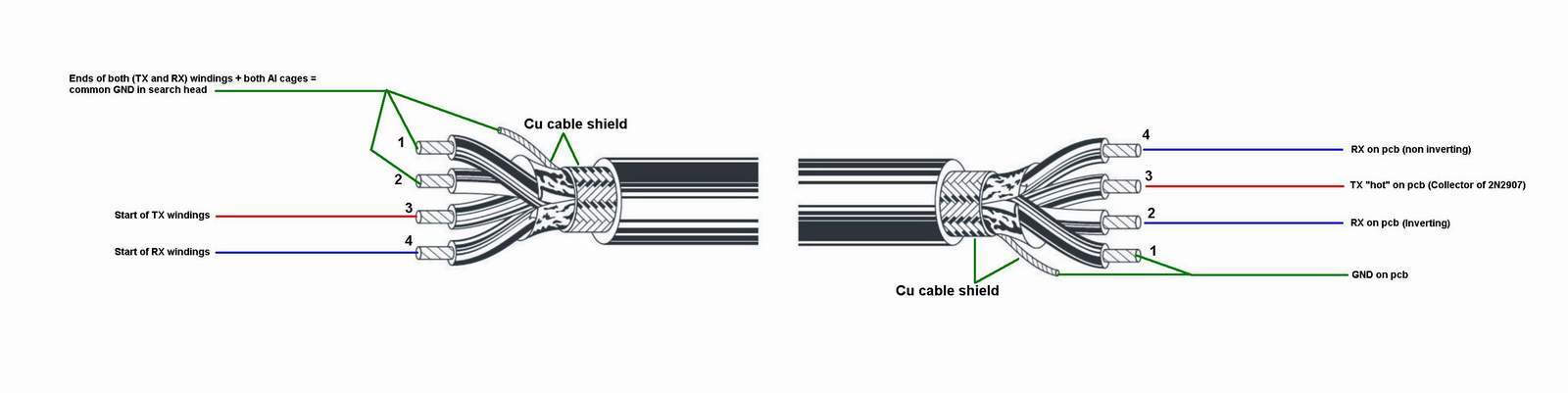

              But... you have to use proper shielded cable from coil to pcb, NOT simple wires.
              Anyway, you almost there.

                        • I posted sketch (picture) somewhere ... most probably on this thread or Tesoro Golde Sabre thread, of cable which suits nice for my coils.
                          Can't find it right now.
                          It is making the difference of how you will connect coils, shield and cable. Better to perform tests and check several options before you close your coil and apply filler.
                          Cable must have nice and rich shield, usually litz wire net.
                          Use cable with 3 separate pvc coated leads (preferably litz too) and all those in common shield finally all coated in pvc or silicone.
                          That's actually common cable, simple ordinary, usually met at most of coils today.
                          Second option (not bad too) is cable with two separate coaxial put in common coating (XP coils are using such cable).
                          Usually i connect cable and than later i perform coil nulling. A assume you will have to re-balance your coils a bit after add proper cable.
                          According to your videos i am sure you already made good coil, now you only have to finish it properly.
                          Cheers!
                          • Here it is one of the options from the past;
                                [ATTACH]34801[/ATTACH]
                                That's the one I used on my original coil which worked fine except over wet grass. Must work as its the same as Tesoro use. The one that worked for me was to directly connect the four TX and RX to the four wires in the cable and shield to the shield of the cable at the coil end. Suspect its something to do with the epoxy and coil shell material and cable combination used. Original brown Tesoro coils are made out of a conductive plastic.
