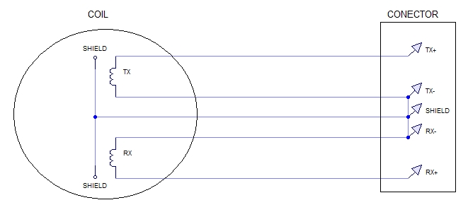

      • if I remember correctly ,
        a long while ago DON BOWER'S offered a solution.
        I have replicated in the picture attached .
Name:	DON BOWERS SHIELD.jpg

            I dont quite understand that pic,if i connect rx- and tx - to same wire of shield i will get shortcut on PCB?

              That's how I did it the second time works very stable.
              • Very quick to try. None hot ends of coil to ground works fine.

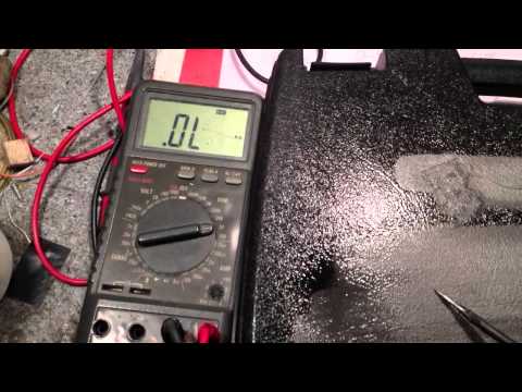

                  I have had poor results with space blanket. Have a look on the IDX thread must have tried 10 different way with no success. The one time it half worked it did not last long. Not tried aluminium kitchen foil. After a bit of experimenting I have settled on PVA glue and graphite.
                  • Hi Koala what ratio of graphite powder to PVA glue did you settle on ? I found that you need a high amount of graphite like 1:1 to get a low resistance with PVA glue, I found useing wood varnish to be best for low resistance .
                      Yep 1:1 is about right.
                      First I add two small squares of copper foil. (copper slug tape from B & Q) Then solder a tag wire to each. Add a table spoon of graphite into a bowl. Then add enough PVA glue so its a stiff past. About the same as toothpaste and towel it on with the back of the spoon. You have to be quick it starts to go off in a few minuets. from memory between the two points came out at 500 ohms whereas two points on the surface was much higher. Once I know I works I cut off one of the tags. This was the quantity for a 6" coil
                      I found a disk of card above and below the coil more effective than applying directly to the windings. Did read somewhere it best to use graphite on a smooth surface. I don't use a coil shell so can't apply directly to the shell.
                      I also tried epoxy resin/graphite mix did not work at all. Rubber glue/graphite also failed. Graphite/yacht varnish worked but not as well. Also reacts with the epoxy resin I was using
                      Not tried normal wood varnish.

                            500 ohms and 1K works well in the real world. 100k ohms not so good. Wonder what the upper limit is for a good shield.

                              I tryed today just for test alcohol and graphite.if you dont use varnish spray you can erase graphite from plastic.every layer you must use some varnish(lack)spray to protect graphite and you cant erase graphite powder plus all when you finish it is conductive with varnish(lack) i think this will be good i will test in my new coil.
