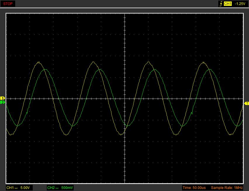

    I built IGSL pcb Silverdog.
    coil tx 6mH (47nF) and rx 6.5mh (33nf)
    the tx frequency is 8.7khz
    I nulling the coil as per attached picture, wonder if tx must be 20gradi early or late with respect to tx?
    this is because while getting the right output sounds ferrous and non-ferrous, do not work the separation adjustment controls.
    there is some error in the diagram or pcb that escapes me?
    I checked the installation and it looks ok.
    tx yellow and green rx oscilloscope

    • Logically I would assume the Tx would come first sense it happens first.
      • thanks Homefirethen the nulling is ok, I have to understand why do not work the adjustment potentiometers.
        IGSL works and gives me the two tones, ferrous low - high non-ferrous, but I can not adjust anything!
