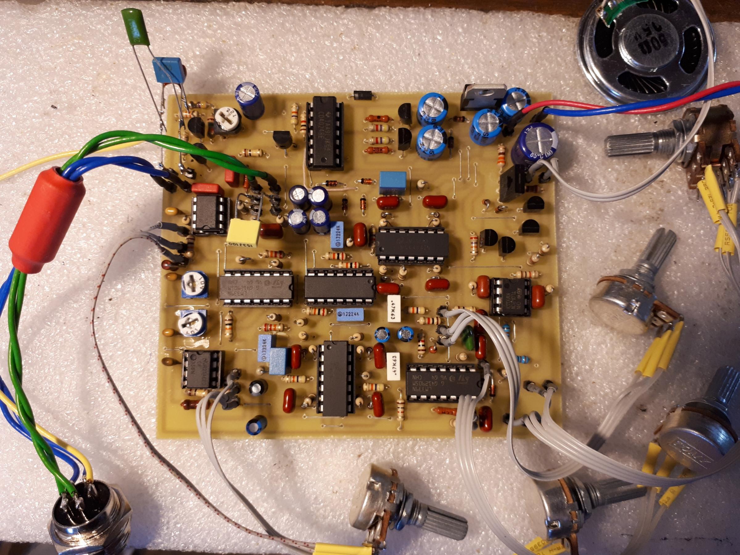

                    • Good afternoon, friends, radio amateurs! I collected the device board, wound the coils under the housing DD250mm:Tx-46 turns with 0.45mm wire, inductance 1.032mH, frequency 8.7kHz, capacitor 330nPx-176 turns with 0.25 mm wire, inductance 14.7 mH, frequency 10.8 kHz, capacitor 15nIt turns out that the frequency Px is higher than the frequency Tx by 2kHz, somehow it is wrong. Tell me, what frequency should be in Tx and Px with inductance 1mH and 14.7mH.Click image for larger version

                      • Tell me, what frequency should be in Tx and Px
                        N10
                        just now i do especial tester for the coil and all same requests will take off in future. thank you for question. http://www.geotech1.com/forums/showt...of-coils/page2
                        • Nice work, looks good!
                          Tx is 14.5kHz and Rx is 16.12kHz.
                          • Originally posted by NĂ¡ndor View Post
                            This is for Tesoro coils, but he obviously made musketeer version -> ~8-9 kHz is ok...
