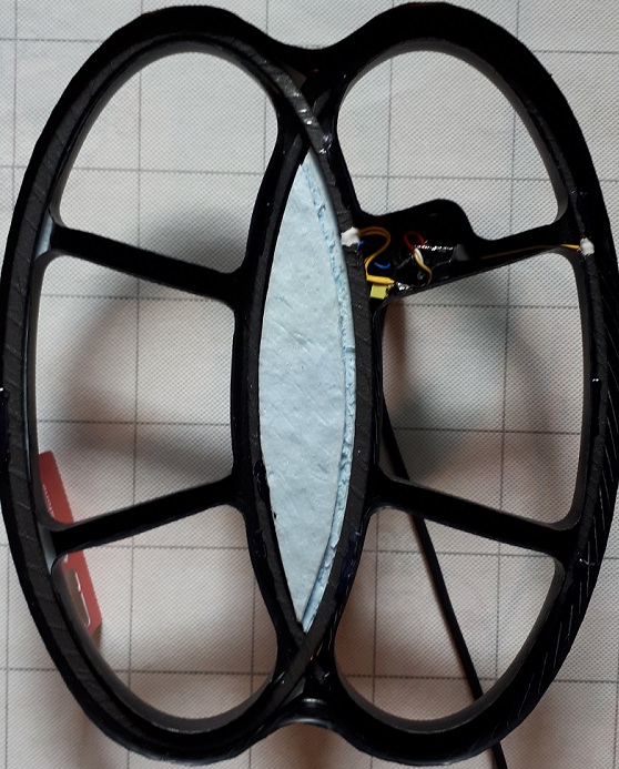

                        • Hello guys,
                          I've built igsl musketeer (pcb from silverdog), without FE block for now, i just want to see NONFE working. I have at home one coil 9" from xp. can i use it and modify only the tx tank capacitor as the xp tx inductance is 10mH? This is my first VLF project.
