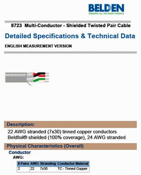

                That's why i had not any problems with Belden cable i used... and you have problems with USB!!

                • For my TGSL coils (and one for IGSL) i used this one:
                  http://thelakes.ca/dt/2009-12-16-131...revisited.html

                        • TGSL "Wet Grass" Coil Connections and grounding
                          The wet grass connections I showed in a previous post, yesterday I think, are from Don and there is no more "loop" in the ground connections (which is generally bad in electronics as you probably well know), where the ground is only connected to one side of the search coil cable at the electronics end, not in the search coil head.
                          Don has also made a change to a connection to the electronics.....and he has tried both fixes (he probably made them!!).....
                          When you previously said build a TGSL coil, I thought you meant the TGSL 101.pdf construction details and that's where I saw the cable, grounding and shield connecting info's, both of them - the original TGSL and the "wet grass" version.....my mistake....
                          So if you are further interested to look at the wet grass connections idea, look at TGSL 101 part 1.pdf from Don....it makes sense for me personally to NOT have any ground loops.....having see the havoc it can bring with it when running long signal cables between digital equipment, I made a lot of money years ago with finding and fixing such problems.....
