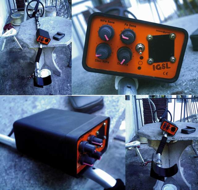

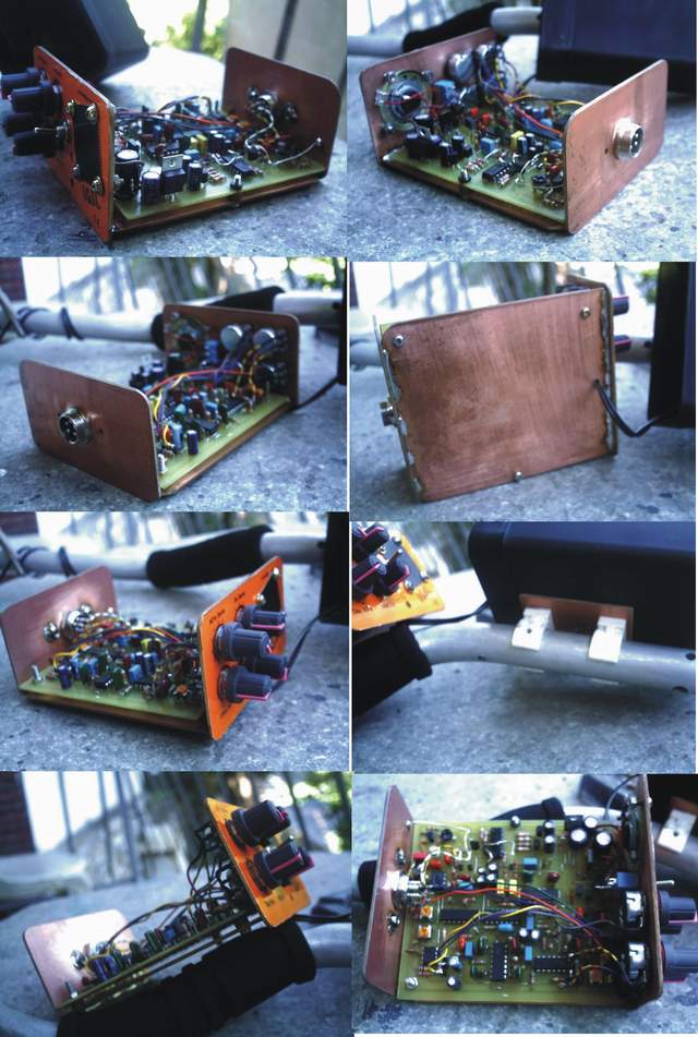

                • Wet grass fix.
                  • igsl finish

                      The wet grass fix.
                      • Originally posted by nakky View Post
                        Ivconic nice work .
                        Grt Nakky
                        Thanks Nakky!
                        Look Selim's work! I like it!
                        Very good work Selim!

                          Ivconic, your MD looks professional! BTW do you bend your own aluminum pipe? I tried to bend alu. pipe with bad results!
                          • Originally posted by Wiltran View Post
                            No i am not..
                            Huge issue! Chronic issue!
                            I manage to obtain shaft or two... from time to time..
                            • Originally posted by selim View Post
                              Nice work Selim. Congratulation.
                                Beautiful, well done....thanks for the pics.
