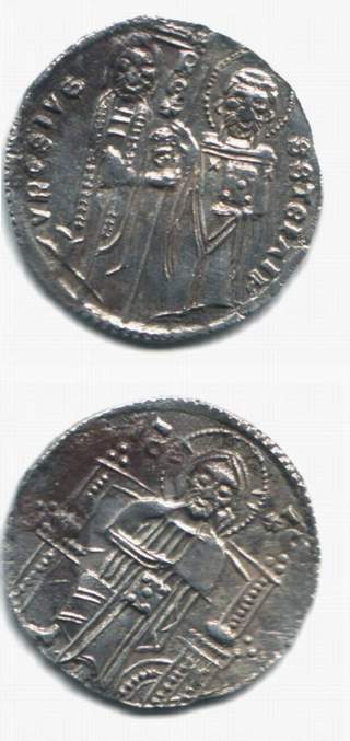

            • From yesterday...
              IGSL's THE VERY FIRST real find...
              • Is that cool? Or What?
                Do you know what it is?

                      • Originally posted by homefire View Post
                        It's Serbian medieval silver coin, "Milutin" or "Stefan Uros II".
