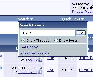

                • Just do this:
                    IMHO you need to trim your nails.
                    That just demonstrates that when metal detecting, Ivconic never needs to take a shovel or spade with him!!!! Less to carry!!
                    • Originally posted by der_fisherman View Post
