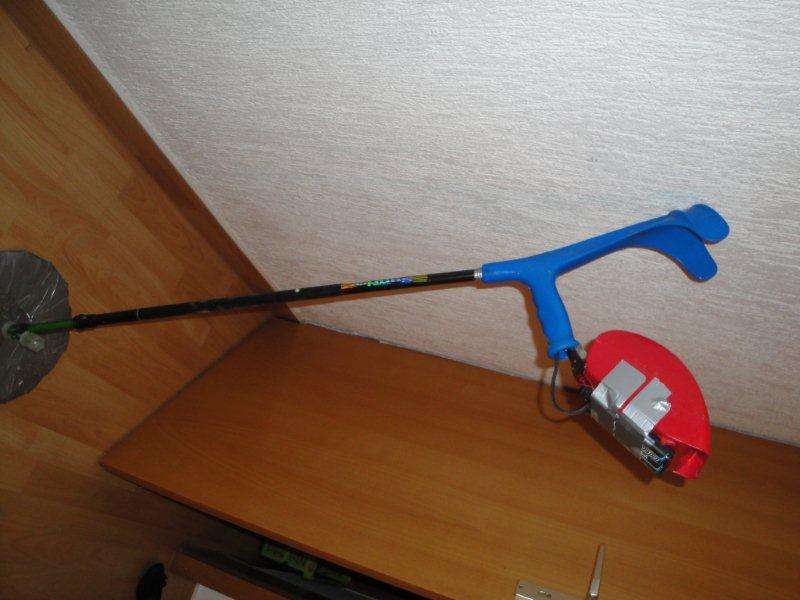

            Here is my MD-Shaft make from a Swiffer
            • Originally posted by mschmahl View Post
              Now we're talking!
              That's what we mean by "got character"...
              How does it perform? Can the coil double as a beret for special occasions?

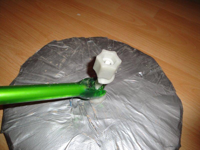

                        • This coil is a basketcoil for the Chance-Detector. I have wrapped it to thick but it work´s well. The cable is inside the shaft. The green parts are from the Swiffer, the Black are a fishing rod.
                          The Coil is wounded on a acrylic glass wich have a hole in the middle. This is fixed with a screw for fixing Toilet seat´s.
                            There should be an award for that. Maybe I can win next year.

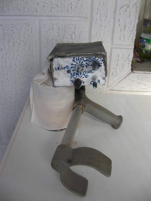

                            • Nothing compares to this one!
                              Definitive a WINNER!
                              (Best Classic III ever made! Guys from White's should learn something about design from this one!!!)
