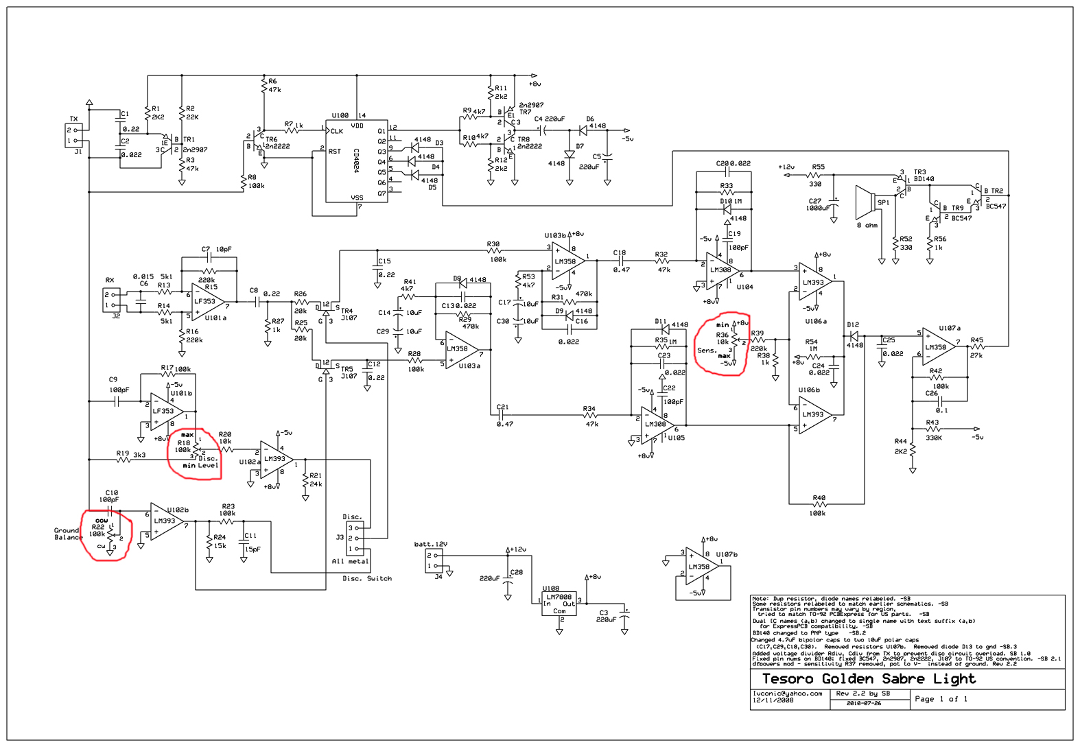

              • Originally posted by der_fisherman View Post
                Dear Ivconic,
                It would be great to know as to which end of the pots should be connected to which connections on the PCB.
                The center wiper is easy of course, but should a signal increase or decrease when turning a pot clockwise for example
                would also help. Perhaps a test point for the scope or meter?
                Andy
                I think on our schematics and PCBs we should mark the non-wiper pot terminals with a meaningful symbol
                such as "min", "max" "CW", "CCW", etc. Might as well put "W" for wiper on PCBs.
                Attached is a schematic for the TGSL where I put labels to give it a try.
                For the ground balance pot I'm guessing how most people do it, and I labeled it CW and CCW for clock-wise
                and counter-clock-wise. I hope others will review and give opinions.
                I labeled sensitivity and disc pots with "min" and "max".
                For min discrimination, it means accepting more metals, and max discrimination, less metals; you can decide
                whether you want to use CW or CCW for min and max. I like CCW for min, probably most people do.
                For sensitivity, min means less sensitivity to noise and target signals -- you need a larger target signal to make a beep.
                If I labeled CCW on a pot terminal, it means that the wiper terminal makes a short (zero resistance) to that terminal
                when the pot is in CCW position. Likewise for CW, MIN, MAX.
                I hope I didn't get it wrong. The IGSL circuit has two TGSL circuits in it and the correspondings pots
                can be found. It does take a little work to relate the schematic to the PCB, so it would save eyeball strain
                and mental gymnastics if PCB makers could label the pot connections on the PCB with meaningful
                labels (including W for wiper).
                -SB

                          I think on our schematics and PCBs we should mark the non-wiper pot terminals with a meaningful symbol such as "min", "max" "CW", "CCW", etc. Might as well put "W" for wiper on PCBs.
                          -SB
                          Pot Direction
                          Hi Simon, you have given me a great starting point for my poti's direction with your TGSL schematic, many thanks.
                          By the way, you appear to understand the poti problem perfectly, so perhaps someone here can decide on a method for use on Geotech for such problems, one that is easy for anyone (even me!!) to follow.....your ideas seem to be good.
                            Pot Direction
                            I still don't know from the schematic which adjustment is Disc1 or Disc2, but that cannot be too difficult to sort out!!
                            Andy
                            Yes, you would need to look at schematic and see which channel is connected to high tone, and which to low tone. It would be nice to label the low tone disc1 and high tone disc2 for example on the PCB/schematic.
                            However you can easily determine this experimentally before you mount the pots in the enclosure. Other than the tones, the two channels are identical I believe so you can set them up (disc pot positions) any way you want by experimenting.
                            I would probably just mark 10 positions and experiment with targets to see where they discriminate.
                            Then I would probably set up my IGSL in one of many creative modes:
                            1. One channel detects iron, the other channel detects everything.
                            2. One channel detects the bottom 2/3 metals (iron, foil, nickel, pull-tab), the other channel detects
                            the top 2/3 channels (nickel, pull-tab, copper, silver). This gives:
                            a. low-tone = iron, foil
                            b. both tones = nickel, pull-tab
                            c. high tone = copper, silver
                            3. Both channels overlap on a single metal such as gold/foil
                            a. low = iron
                            b. both = foil/gold
                            c. high = nickel, pull-tab, copper, silver
                            -SB
