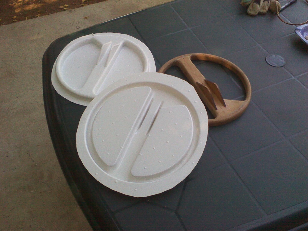

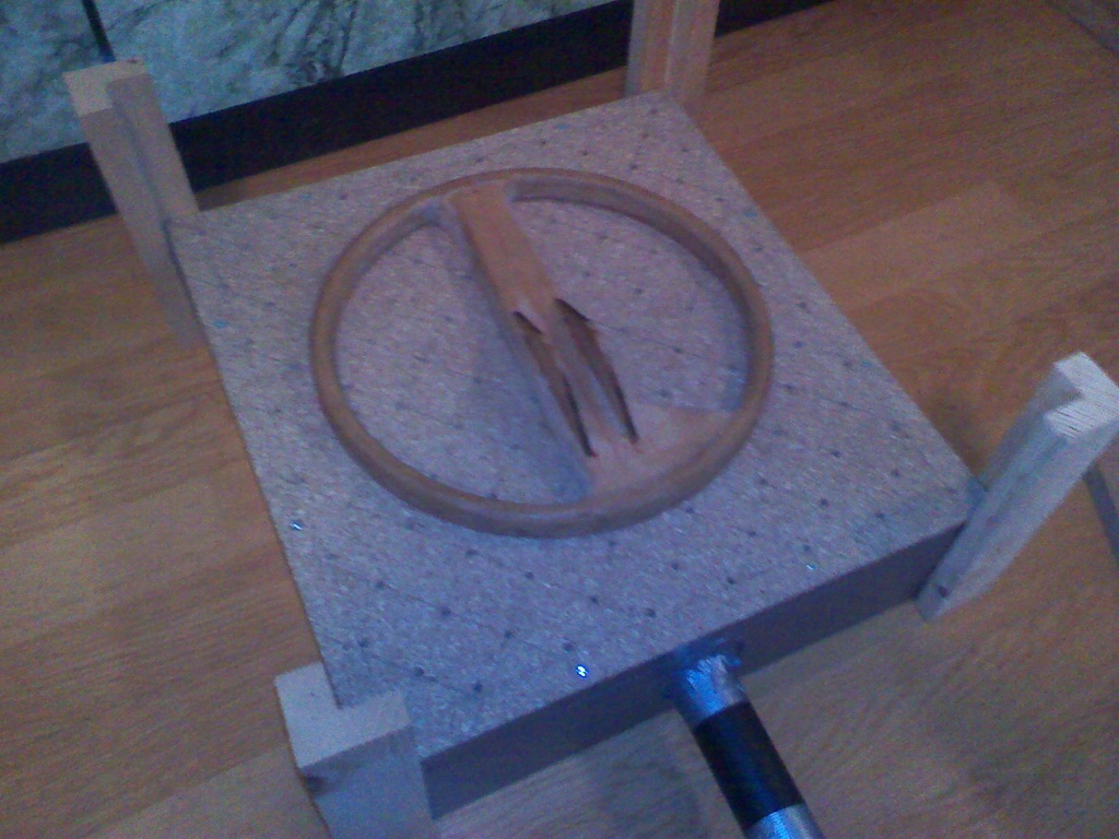

            Hi Golfnut (love the name by the way! But have you only one? "Golfnuts" might be even better!!),
            if you follow the advice given in Don Bower's great TGSL 101.pdf, part I with regard to building a former for the coil production first, you really won't have any problems in producing the Tx & Rx coils, including Faraday shield and insulation. (Even I did it!!)
            I took a simple electronic counter (2 x on ebay for about $8 including post), see that attachment, added some short wires and a micro-switch to it and it counts exactly how many coil turns are made. Still allows the button to work as well if ever needed.....I was happy to buy 2 just in case I screwed the first one up!!
            Now by the time you get those coils done, we (not me though!) should have decided here as to whether a "deep null" or a "4-15mVolt" null is best.....I feel that the "4-15mVolt" is "Winning" at this moment because Ivconic recommends it, but come back and read these pages before setting the coils forever in epoxy!!!
            If you happen to have a wood router in the garage, and you can handle it, I can show you some pictures of the plywood search coil head that I have made, but not yet Epoxyed up!! Light but strong and really easy to produce and make it and make it look good. A few simple rules to make the coil slots as small as possible to reduce the amount of Epoxy (heavy stuff) needed. Any cutting errors can also be corrected with flexible car body filler!
            I have made search coils in this way before and they are still 100% in order!! It seems to work quite well....
            Nuff said!!
            Andy

              • Originally posted by der_fisherman View Post
                This has already been discussed many many times, ad infinitum.
                The deep null will not produce the best results for two fairly obvious reasons:
                1. The initial phase-shift between the TX and RX coils must be correct for the discrimination circuitry to work properly, otherwise it will be out of range of the sample pulse timing. With a deep null, the initial phase-shift is completely wrong. You can clearly see this in the graphs posted earlier in this thread, and a simple experiment involving an oscilloscope will demonstrate this fact. You can even see it in a SPICE simulation.
                2. With a deep null, the residual amplitude is very small (close to zero), which again means the discrimination circuitry is unable to do its job. Commercial Tesoro coils I have measured usually have a residual voltage of approximately 15mV. The discrimination circuits need to sample the RX waveform at the in-phase and quadrature positions. If the RX signal is buried in noise, the detector will fail to function correctly. However, this second point is somewhat academic, in the case of the TGSL (or IGSL), as point one has already been violated.
                As I said several times before - the simplest method of balancing the coils is to use a small ferrite slug. Set the GEB pot to its center position, with DISC off. Move the coils closer together until you reach the null, then continue overlapping the coils until ferrite is rejected. After that, follow Ivconic's suggestions for testing with both ferrous and non-ferrous targets before fixing the coils in position.
