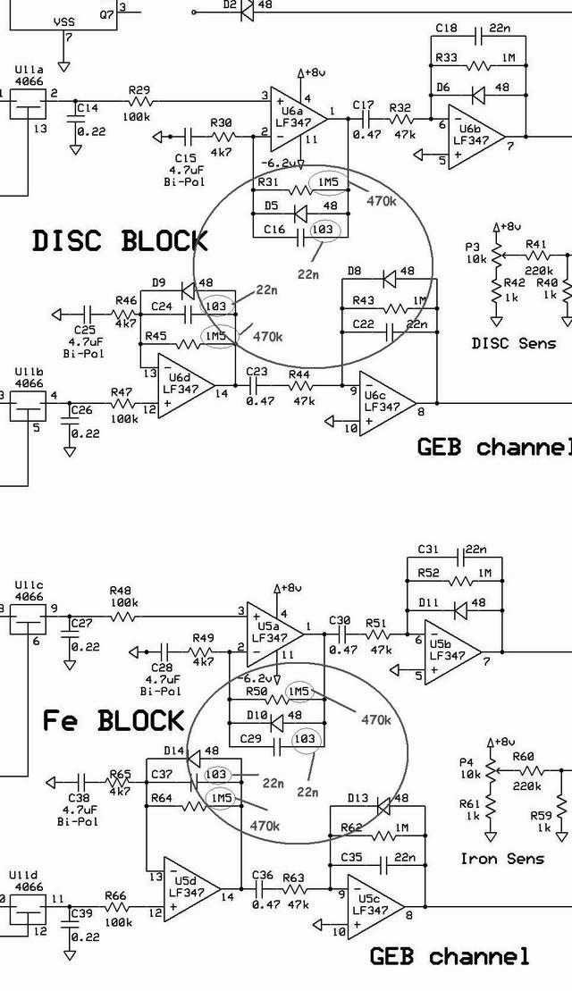

                                Bernte that's good for now.
                                Coil must be more precise balanced.
                                Those small chatters that appears from time to time are caused by increased gain at channels.
                                For now you just do make small changes and return values as noted on sketch bellow.
                                Instead 1M5 put 470k and instead 10nF put 22nF, on all places noted on sketch.
                                That's how you will void those chatters and instability.
                                I wanted to experiment with higher gain than and later realized that it was bad idea.
                                So, when you return values like those are at TGSL, you will not have chatters and instability and therefore will be able to balance coil more easily.
                                Cheers!
