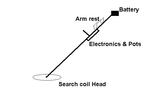

                  • 18 Volt Battery
                    Originally posted by Jerry View Post
                    Hi Andy, I had looked at using battery packs exactly as you suggest. I was very interested until I weighted one and found out it added more weight to the detector than I was willing to swing. Weight is an issue with me because of a bum shoulder.
                    Exception would be Lithium ion battery pack which is light but I do not have one.
                    Jerry
                    If I use them, they will be mounted at the top end of the handle, above the center of balance, so it should make the balance of the machine even better.....we will see!
                    They are heavier, but with far more capacity......but as nothing is set at this time in concrete, maybe I will just remove the batteries from the units, use enough for 12 volts and modify the charger slightly.....then I will have 3 sets of batteries with 12 volts each, probably AA sizes....
                    I have added a simple picture as the shaft has not been found as of now by me.....but I will be using a crutch top as basis, or so is it planned at this time.....
                    Andy

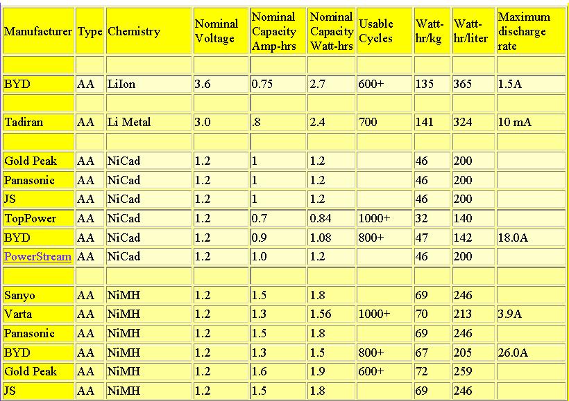

                          • Number of rechargeable cells needed for 12 volts
                            For some reason I was thinking four AA'a and it is eight (1.5 X 8 = 12 ) which would make a little over 5 Oz without the holder. However with your idea on the straight shaft it may not be important. Have not tried that.
                            Jerry
                            Completely wrong, unless you are using old fashioned manganese batteries, most types are 1.2 volts per cell.
                            I have added a chart for your perusal......
                            The only 1.5 volt cells I know of are not rechargeable by the way......
                            Maybe there are some new ones I have not heard of......
                            Andy
