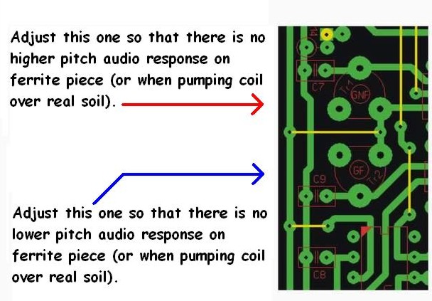

                        • IGSL
                          sorry, missed this one earlier
                          Ground Balance trimmers are Tr1, Tr2, left hand side above LF351

                              • High and Low Tones from IGSL, whch ones?
                                Hi Ivconic,
                                in reply to your recent excellent diagram about the workings of the two trimmers TR1 and 2, do please remember that the tones "High & Low" may not be the same way round as you have made them on your machine, on ours, as there was no indication (that I remember anyway!) from anyone as to what to use where.
                                So either we (you?) set a standard (which I personally would prefer from you yourself, as it makes it far easier to follow any instruction if we are all working with the same design) or we need some other method of defining each pot and trimmer that fits ANY IGSL, no matter how constructed, and will work for. That might be difficult.
                                A "standard" from you would allow those of us (ME for example!!) with the least knowledge of the way IGSL works (I am slowly getting there!) to follow you and the others far far better......
                                I even see slight problems (as it is not so marked on the schematic) with which Pot Disc is 1 and which is 2 (as you yourself call them I believe!). Also you appear to speak of values 1, 2 and 3 etc., but I don't know as to whether you are talking about 1 - 10, 0 - 9 or what, so the numbers mean nothing to me (not that I am so far that I need the numbers yet...)
                                Then there is the slight problem of the orientation of Potentiometers end connections (not the wiper of course) that I believe it was Simon B. that kindly gave some good tips which I followed exactly, but I did not see anyone saying "Yes" it was correct or "No" it wasn't, so I assume he was correct.......many thanks Simon.
                                Due to these small but important differences, it does mean that you could have 10 IGSLs each one different with regard to the way the Pots are orientated, or which tone low/high means etc etc.....which means problems for us beginners when trying to follow instructions and we are 180° "out of phase! so to say....
                                Please do not take any of this post as criticism, it is not meant to be negative, I am just trying to call your attention to the problems we beginners may be up against. When someone as important to us as yourself can give us instructions as to which trimmer refers to which tone for example, we are very grateful indeed, but we must know if it applies to our machine or not, don't you agree?
                                I leave it entirely up to you as to whether you do something about these queries or not, that is your choice, my main aim was only to point out the fact that some of the IGSLs already built, may be quite different to yours, making instructions more difficult to write and for us (me) to understand........
                                I know you are a busy man and if you don't have time, I am still happy anyway......
                                Sent with a very friendly personal regard for your excellent design improvements/changes/instructions/knowledge and friendship to us all here,
