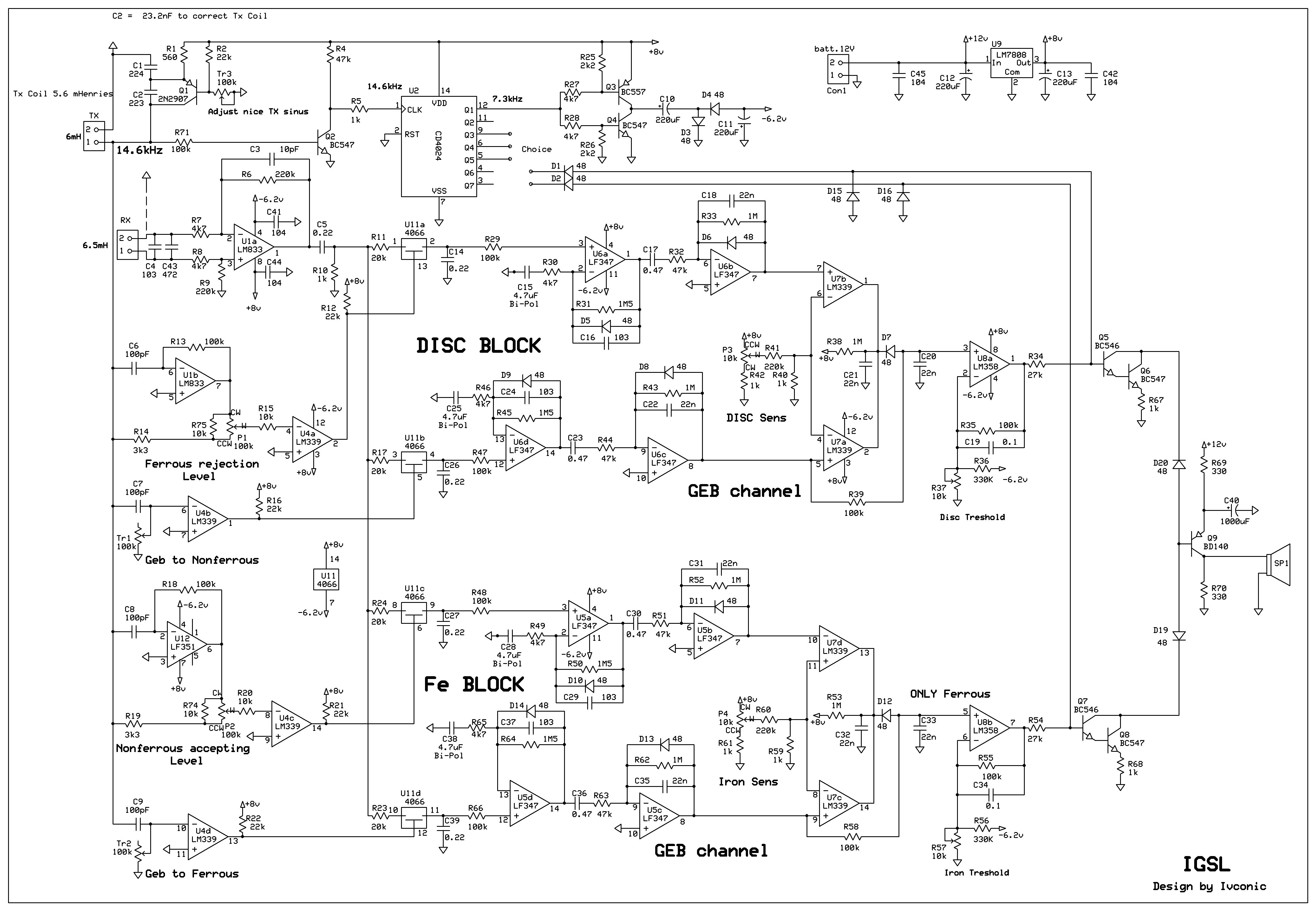

    Gentlemen,
    I have modified a version of the IGSL-TGSL Coils schematic (attached) to what I think is correct with the help of some comments from Simon I think, but just having a look at it, I feel that I may have marked some pots wrongly (either P3 or P4) as the two mentioned, I have marked in opposite directions........
    Would one of you be so kind as to look at my chaged schematic and let me know if the pots are correctly marked with CW and CCW or not? Please check all 4 pots please....
    Thanks in advance.
    Andy

            the scheme published by Andy IGLS-TGLS
            • Mods and changes
              All I did was to mark, using the best infos that I had, the CW and CCW positions of the pots (the wiper positions are obvious).....and the resistor and capacitor changes that Ivconic recommended. I want someone to confirm the positions of the pot connections as I believe at least one is wrong...... The PCB is still the one made by Silverdog. Nothing more than that. Regards Andy PS The component changes "calmed down" my IGSL considerably....

                  For my eyes...
                  Looks like we need same info on GB pots.
