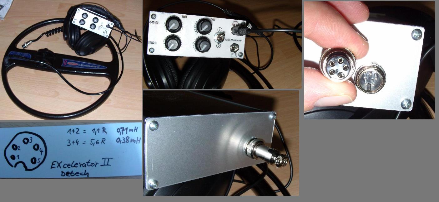

                  • what is it?
                    Thats many hours and nights of work
                    btw: which capacitor value i can take for this excellerator2 coil
                    specs shown in picture
                    thanks ivconic (the one with the idea), silverdog (pcb kit and this nice little connector plug)
                    forum members (great support) and internet and fore sure my wife for sleeping alone

                    • can i use this calculator?
                      http://deepfriedneon.com/tesla_frame6.html
                      • ok i calculated something
                        for excelerator2 coil from detech (0,71mH and 0,38mH)
                        rx 0,71mH 300nf total of caps are 10,905kHz +1,2 = 12,105
                        to get 12,105kHz on tx
                        tx is 0,38mH plus total of caps 450nf reaches to 12,17kHz
                        this way ist ok or?
                        or should i calculate for tx 14kHz thats not so important true?
                        for tx 14,906kHz i need 300nf (100nf plus 200nf paralell) 14,906/1,2 12,42kHz
                        rx 12,42khz 230nF (12,454kHz)
                        sorry im noob on frequency terrain but step by step i know how it works (i think)
                          this way ist ok or?
                          Try using this formula:
                          where
                          • hello Qiaozhi
                            thx but im not a scientist
                            C is capacitance? (Farad nanofarad?)
                            w is Frequency? (in HZ or kHz)
                            L i know but in mH or H
                            f is what?
                            can you explain formula please?
                              hello Qiaozhi
                              f is what?
                              The formula uses SI units:
                              C is capacitance in Farads
                              L is inductance in Henries
                              F is frequency in Hertz (cycles per second)
                              is angular frequency in radians per second.
                              = 3.14159
                              For example:
                              If L = 0.71mH and F=14kHz, then
                              Hence, C = 182nF
                              • thx Qiaozhi
                                peoples like you help me to learn something
                                my old formula book from physics in german gymnasium (engl. college)
                                was to far away and off my brain
                                in shool times 12years ago i could calculate such thinks
                                but think w=2*pi*f - 2*3,14159*14000=87964,594300514210676954014731826
                                c =1
                                87964,594300514210676954014731826²*0,0071 (Henry)
                                result 1,8202282200764905763847273499879e-7
                                0,00000018202282200764905763847273499879 Farad
                                Nanofarad
                                182,02
