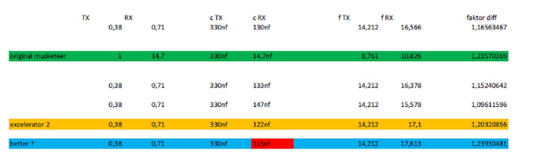

                          ok i have tryed this 2 minutes ago
                          it does not work with my excelerator 2 coil
                          the null voltage i measure is every time 2,6 volt (thats to high) i hear sinus signal at headphone continuous when i turn trimmers on one little point so the oszilator is working i think
                          but coil gives signal when metal object is sweeping over no maybe it is not nulled like the normal coils we know???
                          next days i order a original 4pin tesoro or other minelab - i have laying around a supersearch with 1mH and 20mH i will give it a try before
                          or maybe back to diy coil :-( (so much work but prooven)

                              • could be my solution...
                                maybe it is better to calculate by myself
                                here my result
Name:	optimal tx rx cap combi.jpg
                                what do you mean
