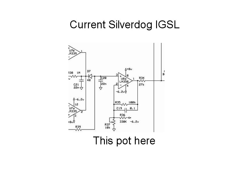

        • Potential 18% extra depth on IGSL
          (good news Maurice on Ur osc.)
          I was scoping my IGSL .
          Arrange suitable non ferrous target (uk 10p coin) get clear tone detect , move away so you get thin scratchy detect. My limit is 25cm. Coin face square to coil.
          Then 1cm beyond and nothing - NO TONE
          At this point / range I was scpoing U8a pin 1 or 3 - what I see is a vertical edge (from the detect) - But No Tone.
          It wasnt 1mV or daft stuff it was in the volts range eg 3 or 4volts.
          (Its -ve and has to flip positive to turn the darlington on to fire sound) If it goes from -2.5 to +0.3 a good detect you dont here a thing!
          I made a few measurements and I get another 4.5cm of solid detect which doesnt trip the audio.
          This extra portion I observe has a rising edge and back down really quick.
          The close range detect here gives a positive going squre wave.
          I may do a schmidt monostable or some such to widen the click to a square wave.
          Steve

                I think what you are seeing is the action of the "noise gate" filter of U8. It is apparently designed to ignore detection pulses of short duration; in other words, a "chatter" filter.
                This is accomplished exactly as you observed -- the detected pulse is integrated, and thus ramps up from V- to V+, and will only trigger a tone when it goes positive.
                Short pulses never make it past the zero level.
                I agree this is a controversial part of the circuit, but it seems to work! However, I think it is something we should think about improving.
                One thing I don't like about it is that it always subtracts some duration from our detected tone. This could be compensated for by adding back the same duration with a timer circuit as some people have suggested -- but I hate more clutter.
                If you feel the noise gate is too agressive, you can put in a potentiometer to adjust the threshold (you can find that circuit in some early TGSL schematics floating around). I'm not saying this is the best solution -- just something people have already looked at.
                Then you should be able to accept shorter target pulses at the risk of letting through more chatter. But if you have very little noise in your area, it may be useful.
                -SB

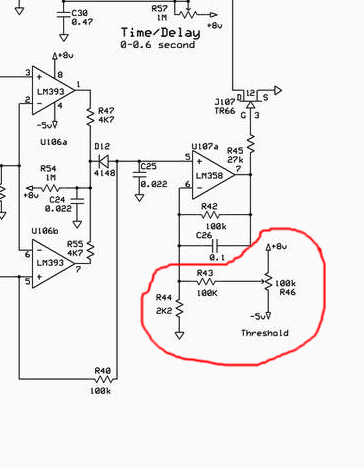

                • My one is IGSL. TGSL is different circuit here.,
                  TGSL has the pot straddling + and - rails to allow the user to get the detect threshold of choice.
                  IGSL there is a subtle delta the pot is on the - ve rail to 0v only - this means you cant get close with the adjustment.
                  S

                    I don't see the pot at all in the IGSL schematic -- maybe I'm looking at an earlier version.
                    I think Ivconic got rid of the pot a while back because it didn't seem useful. But it sounds like you may have use for it. I hope you try putting it in and tell us.
                    -SB
                    • Hi SB this is the pot on IGSL current model from Siverdog
                      I may mod the GND connetion on the pot and take it to +ve rail so more range - my get threshold closer.
                      Steve
                      • sorry done it again.. this one
                          I agree that pot won't give you the full range of control you want probably.
                          -SB
