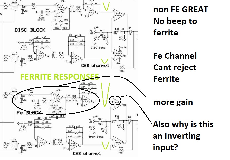

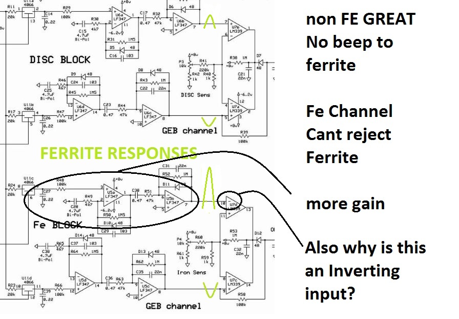

      • Ferrous GEB IGSL - schematic error?
        All, IGSL.
        My one I can get good high tone on the Non Ferrous - reject to Ferrite ie GeB is tunable and ok.
        Ferrous channel always sees the ferrite - never been able to reject it.
        If you look at schematic the disc channel has u7b and U7a both are non inverting inputs.
        This channel is good.
        The Fe block U7d and U7c have one -Inv input and one + Non Inverting input
        This channel dont GEB
        Is the schematic wrong ?????
        Should U7d pins 10 and 11 be swapped over??

          • what confuses me..
            The non ferrous channel works really well.
            The ferrous channel I cannot get rid of any size or type of ferrite and have SOLID Iron GAIN
            Why iis U7d an inverting input ???? Is it this difference that makes it an Fe channel???
            Or is it an error common to all???
            I have a dig on a villa on Saturday and I would like to get it all singing well
            Plus I redid the preamp resistors to 330 and 15k (same gain lower noise)
            I feel the range has improved - I will get some numbers.
            ATTACHED ERROR PICTURE
            SEE NEXT POST PIC
            Steve
            • Better Picture..
                Also why is this an inverting input?
                Because the top section is designed to reject ferrous targets, and the bottom section is designed to reject non-ferrous.
                • 1) I had my Fe channel with no rejection of ferrite...
                  - Field Test - It doesnt matter, ground balances ok as it is on Fe Channel
                  2) I have a oscillation the comes and goes - blips the Non Fe channel.
                  - I erected a Copper screen/fence to sheild the Rx preamp- --- This helped but not enough.
                  _ I wrapped copper tape aroun the 3 P1 pot wires and grounded it --- this helped when I poke finger in nearby and previously I got a blip, now quiet. Not enough..
                  - Added 0.1uF to + and - rail on U4 - not enough
                  - added 1Meg FB resistor to U4a - samll improvemnt - not enugh.
                  Osillation more consistent repetition rate now.
                  - Dabbed a cap on the -ve rail and the rate of oscillation changed ?
                  Tried 1000uF on the -ve rail local to U4 - Sorted.
                  It is much more settled now.
                  It does oscillate if you turn P3 up some more non Fe gain up or Iron Gain too high.
                  I can easily get a Uk 20p buried 15cm in wet clay soil / with small amount of grass on top.
                  Im doing a roman villa on Saturday with it - look a proper charlie with it oscillating away next to 40 etracs
                  S
