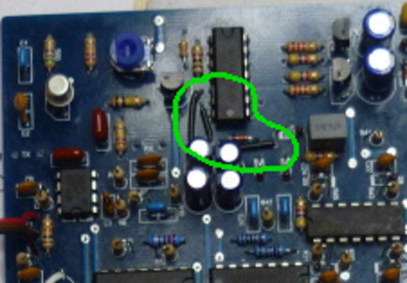

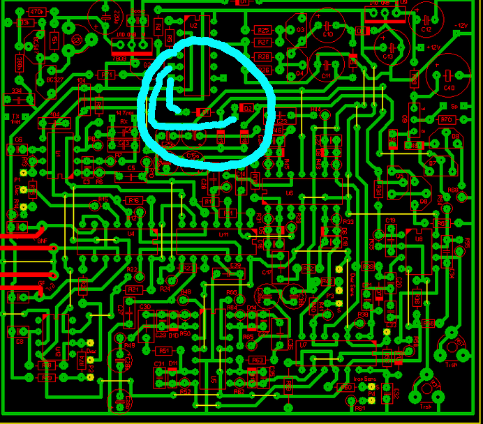

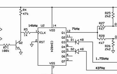

              • I see some empty not connected pads on my board and noticed on one of the Geotech pictures that some jumper wires have been used. Just want to double check whether jumper wires need to be added to my board?
                • you must connect wires for your choice of tones
                  • Originally posted by silverdog View Post
                    As Andy, {Silverdog} says,... you must make the links for the tones you require,.......I personally have the ferrite channel linked to a LOW tone, and non ferrite linked to HIGH tone,....
                    but you must link the diodes to the tone generator chip in the mode that you wish,....... as long as you DO link them!!
                    Cheers, Fred
