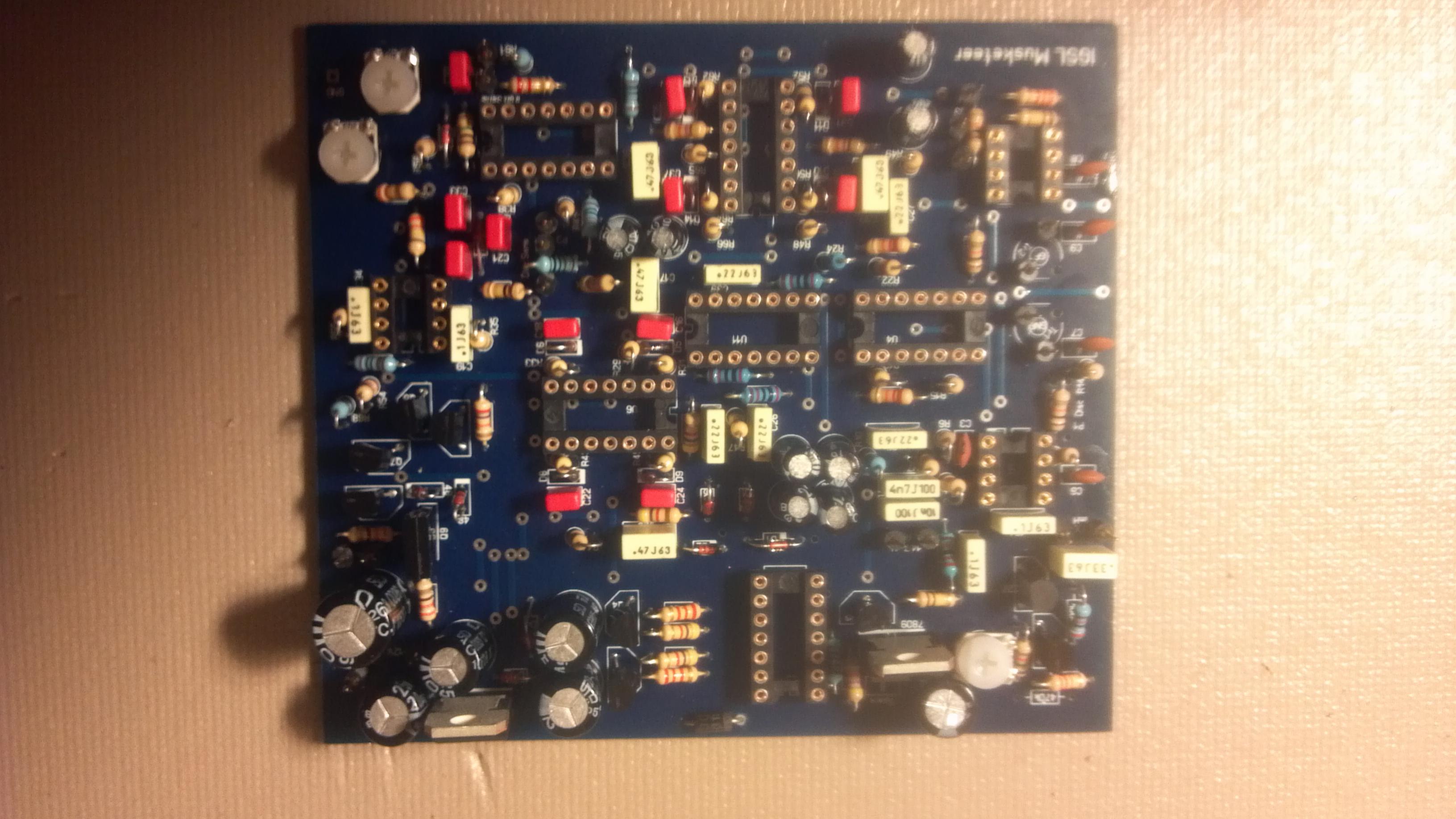

                              • Finished my igsl board
                                Well I finished my igsl here is a picture if anyone sees anything wrong please let me know I am an amateur.
