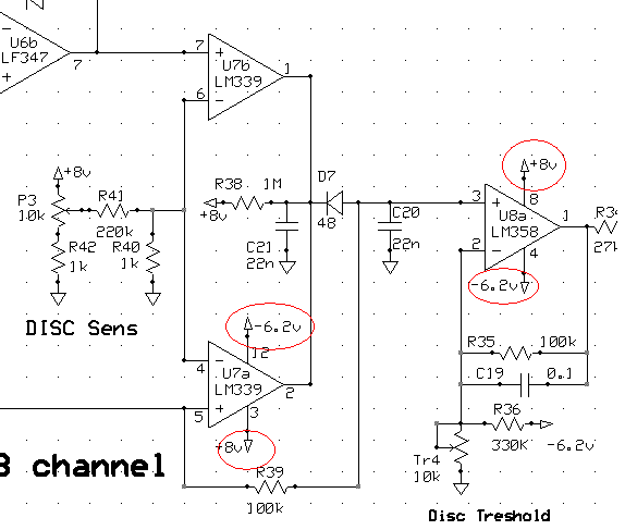

                  • It is terribly late, but I have to say that channel comparators are even more interesting to fix than the channel gain stages. There is a collection of oddly placed components, LM358 forced to work as a comparator ... total mess. OK, it works ... kind of.

                          • As I said, it is a total mess. I have something cooking to fix it for real, but for the time being I have a quick fix that will improve it a lot, at least in sense that audio does not lag behind the actual target detection. It is very simple: just get rid of all the capacitors around LM358 and the comparators.
                            Let me show you...

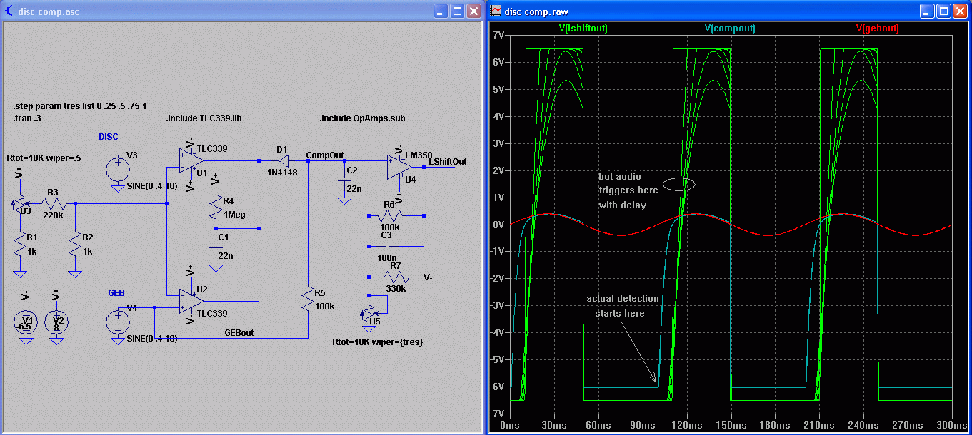

                            The first picture is a current state of the art (!?) and the corresponding signal plots. Observe how LM358 hits the rails. It is that bad. It is configured as a level shifter, but poor thing is just banging up and down.

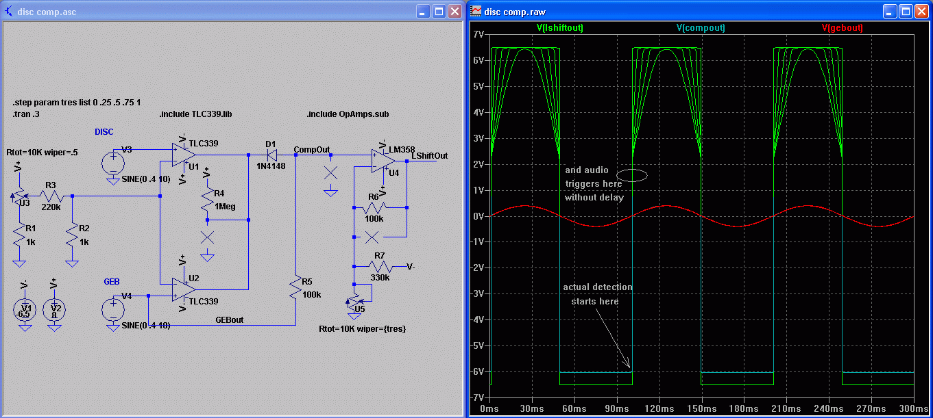

                            The second picture is the same thing, but without all the offending capacitors. See how picture instantly beautifies. OK, it may look a bit more beautiful, but it is still a saturating crap. I'll fix it soon.
                            Also you'll find attached the corresponding artwork (!?) in LTspice. Again, It must have been completely OK before someone "improved" it. There are some misplaced components laying oddly here and there, and that is fixable - even without PCB rework.
                            • I guess you implied symmetrical supply there? (according to pics)
                              If yes; than it is not the case with initial IGSL setup.
                              • It is +8V and -6.2V or just as per the schematic in ExpressSCH and elsewhere. I guess it is not +8V and 0V because it would not work well at all.
