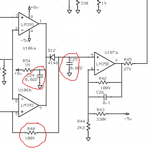

        Referring to the TGSL circuit, C25 (.022uF) and C24 (.022uF) directly affect the rise time of the pulse coming from the comparator outputs. I think these LM393 comparators are "open collector" outputs, so when both triggered high, their output voltages must be pulled up by the signal coming through that 100K resistor -- but because of the two capacitors, it forms an integrator which slowly ramps up the voltage as the caps charge.
        In quiescent mode, the non-inverting input of the LM358 is held at approx V- (negative rail) +.7 because the LM393s pull the voltage down. When a target signal arrives, both LM393s go "high" open-collector, which starts the ramping up of the voltage on the caps from the current through the 100K resistor.
        Because the audio will not sound until the LM358 non-inverting input exceeds the inverting input, there is a time delay while the voltage on the non-inverting input is ramping up. Short pulses will never make through at all.
        In fact, this is one of the weaknesses of the chatter filter -- noise riding on a weak target signal can break it up into small pieces that never get past the time delay and you hear nothing -- which may have been the intent of the designers, to make a clean signal, or none at all, to market to the casual hunter.
        We (obsessed fans) may actually prefer to hear the complete noisy signal, so with experience, we can learn to interpret different degrees of chatter and derive more information about deep targets at the noise threshold.
        So I'm all for experimenting with designs that eliminate the chatter filter. I did try it briefly, but couldn't get satisfying results. However, it is on my list for further experimentation.
        I agree the extra RC network of C24 and R54 seems extraneous -- I think C24 and C25 could be consolidated into one capacitor and R54 eliminated.
        It would be useful to build a prototype where you can switch in and out the chatter filter and see what you like best. In any case, we'll be interested in your impressions when you build the circuit and use it in the field.

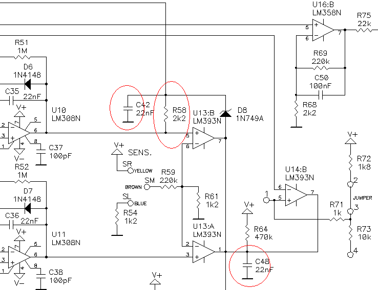

        • You can't imagine my expectations
          You are right about most of the things, however, my analysis shows that time constant with 100k and 22n+22n is far too much. Actually absurdly slow.
          Anyway, I found where this whole oversized capacitor business comes from. In a King Cobra schematic I found solutions that were copied from there, or a common ancestor of them both, which make much more sense there than in TGSL/IGSL. Even the meaningless 100k resistors at channel amplifiers inputs makes sense with bjt opamps as used in King Cobra. When you see it - you'll find it obvious. Red circles show the two capacitors, and they both are 22nF, same as in TGSL/IGSL. However, a resistor that also determines the time constant here is 2k2, which is ~45 times less than 100k in TGSL/IGSL. Besides, the C48 in King Cobra is active only in a smaller portion of the ramp because a zener diode takes care of that.
          Having 100k in TGSL/IGSL calls for 470p to maintain the same time constant. Yeah, I think it may work just fine, and it would improve somewhat signal shape for small signals where level shifter kicks in too fast.
            I don't know... the time constant is 4.4 milliseconds. But consider -- the LM308 output pulse is typically near ground level for weak signals; I'm not sure the upper limit for large signals, maybe V+ without the diode; but with the diode, it is around .7?
            Now it depends where you set the threshold voltage of the LM358 on the inverting input. If you set it around .7 (maximum output of LM308 with diode), then it would take a really long time for the capacitor to charge to that level because of the exponential curve. The lower you set the threshold, the faster the caps charge to the threshold. If you set it at .37 X (.7 - V-), it should take about one TC (4.4 ms) to reach the threshold and trigger the audio tone. So you can easily choose from 4 ms to much longer for your chatter pulse rejection.
            If you take away the diode, the same logic applies at a different range, maybe V+ for max signal level.
            The thing that strikes me about this is that weak signals would seem to have more delay reaching the threshold than strong signals, because of the exponential charging curve. That seems unfortunate. However, that is offset by the fact that the weakest signal will be near ground level at least, and if we set the threshold low enough, we can get a decent ramp up before the exponential curve hurts too much. But I still don't like it -- if anything, we want to favor weak signals as much as possible. So I'm all for improving this kooky chatter filter if possible.
            That R58 2k2 resistor looks more like it may be part of a Schmitt trigger circuit to me, which also cuts chatter in a different way. The R64 470K resistor with the 22nF cap I think is the time delay chatter filter similar to our TGSL, and it has even longer time constant. But the actual time delay rejection will depend on the relative levels of the threshold and starting voltage of the ramp.
            That is a nice find by the way; it is interesting to discover the geneology of metal detectors; your point is well taken that often circuits are copied with no sanity check behind them.
