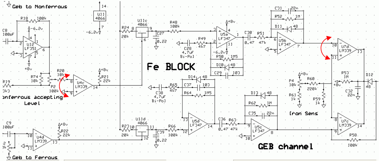

                        • I've found one mistake in "Ferrous channel" and it will not be too easy to fix on the existing board. It is related to the inverting/noninverting inputs of comparators U7d and U4c. They both need to be reversed for correct operation, and it will not be trivial
                          Let me explain. Comparators contained in U4 clock the 4066 switches by phases set by the preceding circuitry. Resulting signal is amplified in respective channels and fed to U7 comparators that form analog AND circuitry. For non-ferrous detection GB AND non-ferrous disc signal make for non-ferrous detection. To make them less hectic there is a "sens" potentiometer control that actually provides a threshold below which there is no detection and it works fine for non-ferrous channel ... but not for the ferrous discrimination channel.
                          It becomes active when there is a positive signal on ferrous GEB channel, but also for 0V on ferrous disc channel - which makes no sense. It is supposed to be active only for negative signal in ferrous disc. channel.
                          It can be kinda corrected by "Nonferrous accepting level" potentiometer, but it is level dependent and gives oddly overlapping results at low target response levels. I guess lots of chatter too.
                          I'd propose a solution with exchanging pins 8 and 9 of U4c and pins 10 and 11 of U7d. It would make "Iron sens" control behave as expected and overall behaviour more predictable. It would reverse phase of the ferrous disc. channel, and it will make discrimination comparators work for positive signals, and it will make "Nonferrous accepting level" potentiometer actually do its job.
                          In my builds I'll have to make it "ikebana" style by first extracting the existing sockets, doing some nasty acrobatics with wires and it should work correct then. Too bad I did not notice it before the sockets got welded Maybe I'll better cut the lines on PCB and rewire everything there - seem like a bit less trouble.
                          here is a picture of the proposed changes:

                            • I'll do it for sure, and I hope to have everything completed by weekend. Most probably I'll get busy balancing the coil, but anyway, It will be soon.
                              This correction is not the most obvious one because phase needs to be reversed somewhere, and it seem as if it is all the same if you do it at U4 or U7, but it isn't. There is a threshold "sense" pot that requires positive signal to perform correctly.
                                Treshold works perfectly well on both blocks, already.
                                But i agree with you that there are better ways to process Fe signal there.
                                Obviously many people already faced problems at Fe block. I don't know why?
                                All the time i was convinced that they do have problems with their coils.
                                At my IGSL's Fe block is acting pretty calm and smooth as well as Nfe block too.
