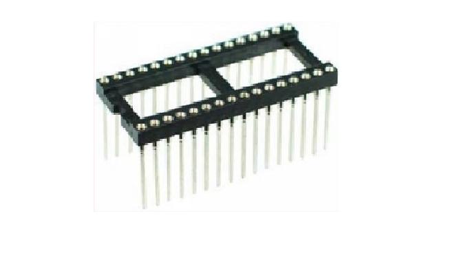

            what I forgot to mention, if you feel the need to remove the original socket, is to buy "wirewrap" sockets, they have very long legs, and insulate both the legs to be crossed over and then carefully bend them to their new position, solder in the socket so it sits about 1 cm above the pcb. This is mechanically almost as good as the original socket on the board once all legs are soldered in. Solder both sides, that is top and bottom, for extra strength and rigidity.
            here is a picture of one type or such a socket, they belong in every workshop....
            Andy

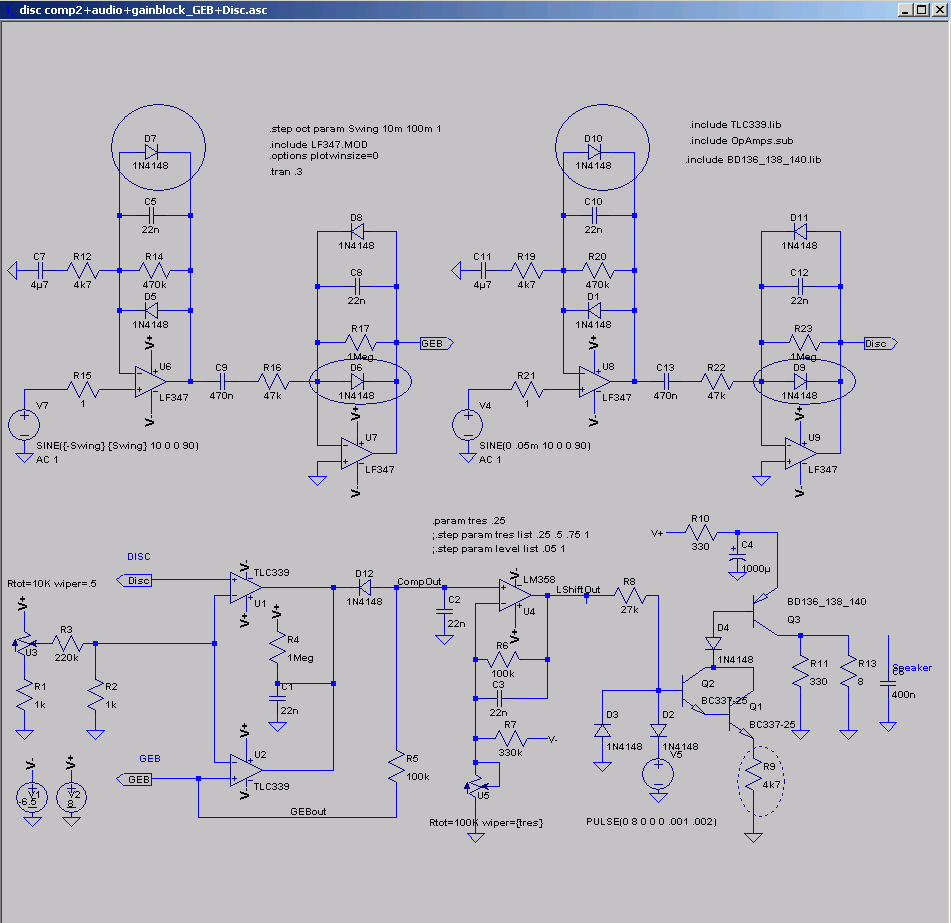

                              I made a LTspice simulation of a whole disc + GEB + comparators + audio stage
                              It may require some tweaking in LTspice control panel because of the comparators that are famous for sloooooow convergence, but here you go, I made some changes to the original setup, but they are in circles, so have fun.
                              I think I've found the main source of chatter, and I wonder if someone else will get to the same conclusion. If someone wishes to know what is what here, just ask
                              • I am still populating my IGSL and due to some family obligations I'll have to stop for the weekend
                                Anyway, I think I found the main source of chatter and odd and shortened responses. It is the combination of LPF and compression that in effect shift phases between GEB and Disc channels. Otherwise they are in phase or in counterphase, but these shifts make things more interesting. I'd say signal is overfilterred, and I may come up to some bullet proofgain stage that behaves.
                                Keep tuned...
