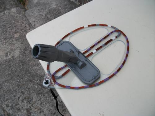

      We got a bit of a weather here, strong storm grade Bora and wild fires. My portable "lab" is outdoors so instead of IGSL i made some flapjacks.
      I realised that cable gland is upside down, and that shaft fitting may require some extra and non-metallic support so I have something to play with.
      Anyway, this is how it looks so far. I'll pot it with hot glue at the end. I don't intend to apply any foil. My Coil is center tapped bifilar, and my preamp is true differential.

        Yes we here also had pretty stormy night! Thunders and lightnings all night long!
        Looking neat and clean work! Nice!
        Plastic part is taken from vacuum cleaner i suppose?
        You don't intend to apply any foil? Ok, but you certainly must apply any other form of shield!?
        Otherwise such unshielded coil will not perform calm on real soil.
        Maybe you are lucky and can obtain special filler with iron oxide particles inside?
        Any method you use to form Faraday cage is better than no one, trust me.
          No, but close, it is the flat mop with foldaway head - you just dismantle everything and there you have a shaft fitting and a head that is moveable front-back and sideways. Got it cheap at fair.
          I won't apply any shielding for now. I'm quite confident that this setup will perform without any. While nulling the coil I did not notice any proximity effect due to hands etc. so I guess it will be OK.

          Plastic body is plexiglass sheet that I cut into an ellipse (drawn by classic method with two focal points) + an ear for a cable gland, using an arc saw. I got 2 bodies out of 50x25cm plexiglass sheet. Very tight.
          • As a matter of truth; there were several genuine metal detector in the past with unshielded coils. I can't exactly recall those models right now. But fact is that those vanished in time.
            Everybody now days are making ONLY shielded coils. Must be a very good reason for that.
            Once even i tried to make one unshielded coil. Was omega coil for my Micronta 4003 variant, called MD3007.
            That coil indeed worked like a charm on the bench, in the air. Perfect.
            But later was useless on real soil.

              Looks nice
              Why dont you just put the cable jonny the correct way round and drill a hole through the side and give yourself side entry, then just seal with hot glue.
              Dont know what country you live in but shielding is a must over here unless you have a magical formular.
              Tryed once just shielding RX which was fine in open field until it faced the ground which rendered it useless.

              • An unshielded coil is practically useless in the field work. I use shielding to both coils, TX and RX. I prefer the aluminum adhesive tape, because it handles very well and does not usually cause any problems in the field.
                • Well, I can understand why, but my approach is a tiny bit different. Shields, as applied to MD coils and LF loop antennas, are a remedy for static fields, BUT not required with center ground tap. A prerequisite for such setup is a true differential input, or a symmetric/asymmetric transformer. My choice is a true differential opamp input.
                    Well, I can understand why, but my approach is a tiny bit different. Shields, as applied to MD coils and LF, are a remedy for static fields, BUT not required with center ground tap. A prerequisite for such setup is a true differential input, or a symmetric/asymmetric transformer. My choice is a true differential opamp input.
                    Many of coils i know do have also center tap and still those are good shielded.
                    But ok for that, it is interesting approach and i am very interested in what you will achieve with it. All the new ideas are always very interesting and attractive.
                    But i thought first you gonna make genuine IGSL setup to have reference and later you will make your idea. But now i see that you actually don't have intentions to make original IGSL at all.
                    That's situation when we all will not be able to compare our IGSL's with your modification.
                    Ok, it's your choice.
