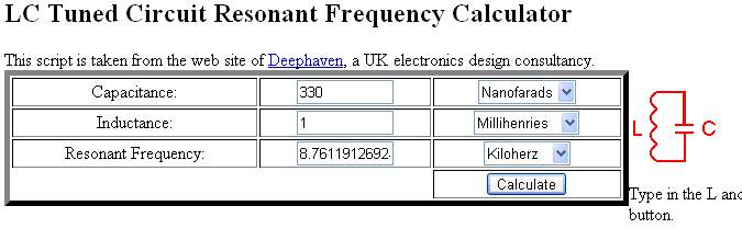

        Yes, i was confused too! Actually it was like this:
        i removed previous TX from a pcb and put another, different one. I had no idea what would be TX LC tank values. I knew TX coil is 1mH (TS1000) but was to lazy at that very moment to calculate L. So i made pretty wild guess and put 0.33 (ooops! secret a bit revealed!!) and switched it ON. It started to work just SPLENDID from a start! It's a kind of luck and nothing else. Later i really did experimented with RX cap (15nF) to see if some more benefit can be gained.. but i had no progress. 15nF seems to be most proper choice again.
        How is possible to work such good on 8.5kHz?? I don't have a clue, honestly speaking!

                  It is Minelab TS1000 (24.5cm) coil. TX=1mH, RX=14.7mH
                  A 15nf cap with 14.7 mH coil gives a freq of about 10.72 Khz. With the transmit of 8.76 Khz. This fits very nicely with the 14.5/16.1 Khz relationship of the TGSL. This makes me wonder if you can take most any coil and check resonant frequency of the receive coil and then tune up the transmit oscillator 1.4 - 1.9 Khz lower and make it work with either TGSL or IGSL circuits.
                        Very interesting thread I am very busy taking care of wife's health concerns right now otherwise I would be doing the experiment rather than just asking the question.
                        Jerry
                        Good thinking!
                        Along with Minelab TS coil i also tried Excellerator 36cm DD coil made for Fishers 12xx serie. Not good results!
                        I changed TX cap few times, experimented a bit - but i couldn't achieve good results as with TS coil.
                        Excellerator coil has TX=~2.4mH and RX=~10mH.
                        So this just justify exactly what you pointed...

                              Exactly where I was going.
                              • Originally posted by Jerry View Post
                                Jerry
                                I am wondering if, with lower frequencies, the 90 degree DISC range will be enough for discriminating all metals, or if we need more range. Some practical tests would be useful to answer that.
