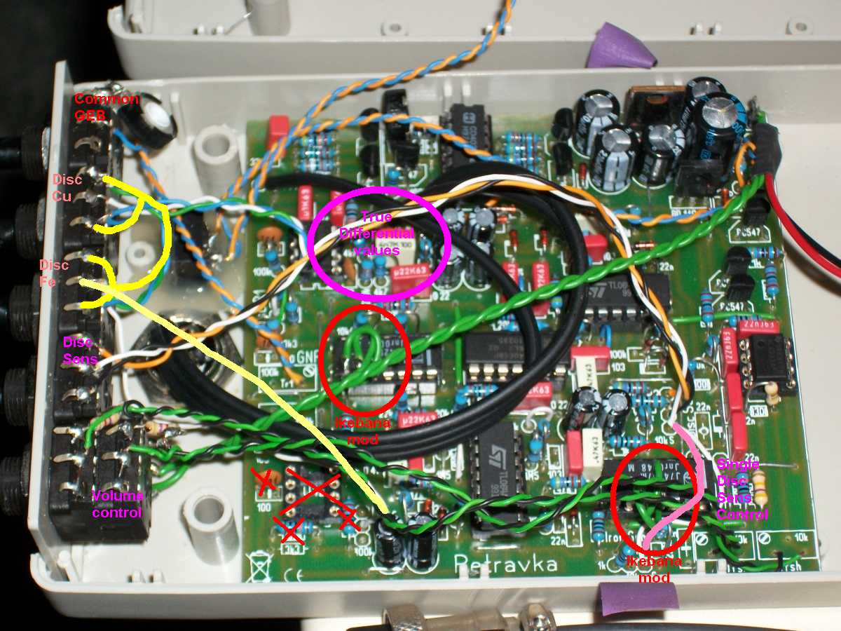

            • Thanks, I'll take a day or two to decide on final touches and then you'll see it all.
              Let me just gather some thoughts on differences against the original IGSL.
              - I joined GEB of both Cu and Fe channels together, and also ported it to a 10k potentiometer for fine tuning. It is less confusing this way. Now that I think of it - there is a spare channel doing ... exactly the same job as the other GEB channel, and it could work as an "all metal" (GEB) with time constants improved for pinpointing ... just a thought.
              - discrimination potentiometers are as they are in original.
              - I joined "Disc sens" (in reality low signal threshold) to a single pot. Ikebana mod allows me to do that, now that both channels work by the same principle. Again, this is less confusing this way.
              - "threshold" controls are now ported to a stereo potentiometer and provide some volume control. I'll have to put a few kohm in a series because the binary sound sucks.
              About the guts...
              - frontend is a true differential amplifier with input impedance at 6k8 - I found resistors combination from E6 that do that nicely. It can work happily with regular coils, but I arranged my DD coil Rx as a center tapped bifilar. So far I did not notice any problems with static, and I guess it is fine. On LM833 output it produces 40mVpp so this seem to be OK.
              - I joined both GEB controls to one by connecting pins 1 and 13 of the phasing comparators, and disabling the other one by forcing it high.
              - LF351 is not used, yet by inertia of populating a board first - decide on mods later, I left there a few components that are not used.
              - gain stages were set with both diodes in a second stage, and with feedback capacitors removed from the second stage. I can write about it whole day and more, but the consequence of this setup will be more obvious in a video.
              - I removed all unnecessary bits from the comparators section, so there are only 100k resistor, and a 22n capacitor. The diode is replaced with a short. Together with modded gain stages this stands for full duration of beep over a target. Disc sens controls are merged to one.

              It is balanced by hand-squeezing it here and there, from outside to the inner overlap, fixing it with a crazy glue to a plexiglass form. At the end only a small portion of it remained unglued + a small curl for finetuning. I noticed that the curl was not of essence, and that most probably the coil would have been nulled even lower without it - it breaks coil symmetry. Now I have less than 1mV of unbalanced signal, and I just can't make it go lower. I'll not put any shielding on.

                        My shaft is almost ready. I'll have to decide on how to attach a device to it. Batteries will not be a problem as I have a stash of 9V cubes that are beyond expiration date, but still pumping juice. Maybe I'll just hang it losely - I don't know. I did not think that far. When I do - it is movie time.
                        For the time being, I'll just attach a retouched photo of the current state of the device. Funny thing is - I did not bring any LM358 to my li'l island, and I had to improvise - I've put NE5532 insteadstick:
                        In this place this is actually a bad choice because of the protective circuitry in NE5532's input - but it works. TL072 didn't.
                        So here is a photo of the upper side in a box. There are only two shorts extra on the lower side so it is mostly WYSIWYG:
