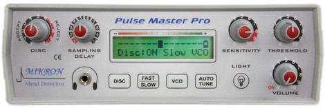

    A have some unclear things about this md , i know that this type of pulse md must be kept at a certain distance above the ground when searching whit big coil. I have also a small coil that must also be kept high. Do you think if i use a shilded coil , it will lower the hight necesary to opertare it? , or improve/lower performance?
    Second question, is this md a modified version of delta pulse or other popular detector? (i have athached some pictures for you)

      Do you have front panel of LCD photo ? Also is that a switch under the right side potentiometer , of top photo where the 6 wires are connected ?

          It is not a switch ,it is the audio jack , don't have a front photo of the lcd panel.

                      I noticed a worrying thing , it does not detect gold , a mean not small gold like rings , but a whole gold chain. (36 cm coil, tried all settings) It will detect other objects like a piece of stainless steel 10 x 5 cm , or small brash or copper coins, but not gold. Any sugestions on the probable cause ?

                        In first line this device is not projected for tiny gold prospecting. Second, your 36cm coil is about twice too large. Solution: use coil with smaller diameter, say 20 cm or less and you probably will catch your ring.

                          My Pulse Master pro detects all gold objects,even small rings.But rejects if i use more than stage 7 in discrimination.
                          Not believe that your PM pro is diferent,unless the electronics inside was touched or modificated.

                            Unfotunatly mine had this problem before I opened it(not just for small gold but also large....whole gold chain) I didn't made any mods or changes to the internal setings, yet. There are two cerment pots on the pcb ,i gues one is the pulse width and the second the secondary delay ? (not sure if i'm corect ) Can somebody say ?
                              Morgan , does your 36 cm coil have a huming noise (like that of a transformer) , mine has such a noise and i supose it is due to the wires being very close inside. Is this normal for a pi ?
