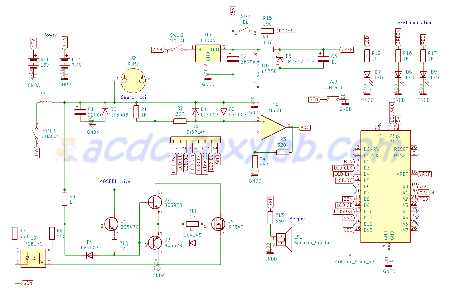

      • I have drawn FoxyPI v3 schematic in KiCad (see attached image for zoom):

            • OpAmp LM358 too slow for PI-detector
              • Originally posted by Eddy71 View Post
                Probably it is.
                But he is trying very hard. :-)
                All this device is a compromise between extreme simplicity and acceptable sensitivity and stability for me.

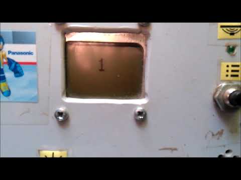

                  • Video illustration of metal detector starting procedures:
                      Yes, thats why im wondering to! But in opposite shorter bandwidt will produce a less noise) Of course analog part of this detector is less good than digital, so simply placing ne5534 instead of lm358 will boost sensivity. Also high-pass RC filter with R10k and C 0.1 uf beetwen op amp and atmega will be nice, as it help to reduce low frequency noise. I think at nowedays lm358 is one of the best op amp for flicker noise generator project
                      • FoxyLab make a nice project. At least simple and good as reference for comparsion.
                        Sory i forget about common mode voltage range limitation, ne5534 will not work here, tl071 will do.
