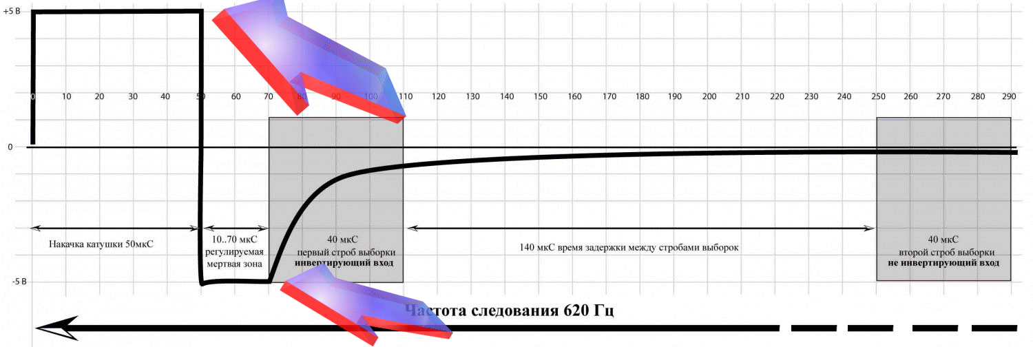

                            • Hi Foxylab, just wondering when you monitor the output of the LM358 with a CRO, what is the voltage range between the highs and lows of the signal ? thanks
                              like between arrows.

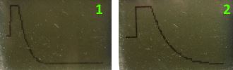

                                Hello!
                                Here are the signals at the ADC input - without a target (1), with a target (2). The upper horizontal line is the saturation of the ADC (voltage >= 1.235 V), then voltage gradually decreases to zero.
