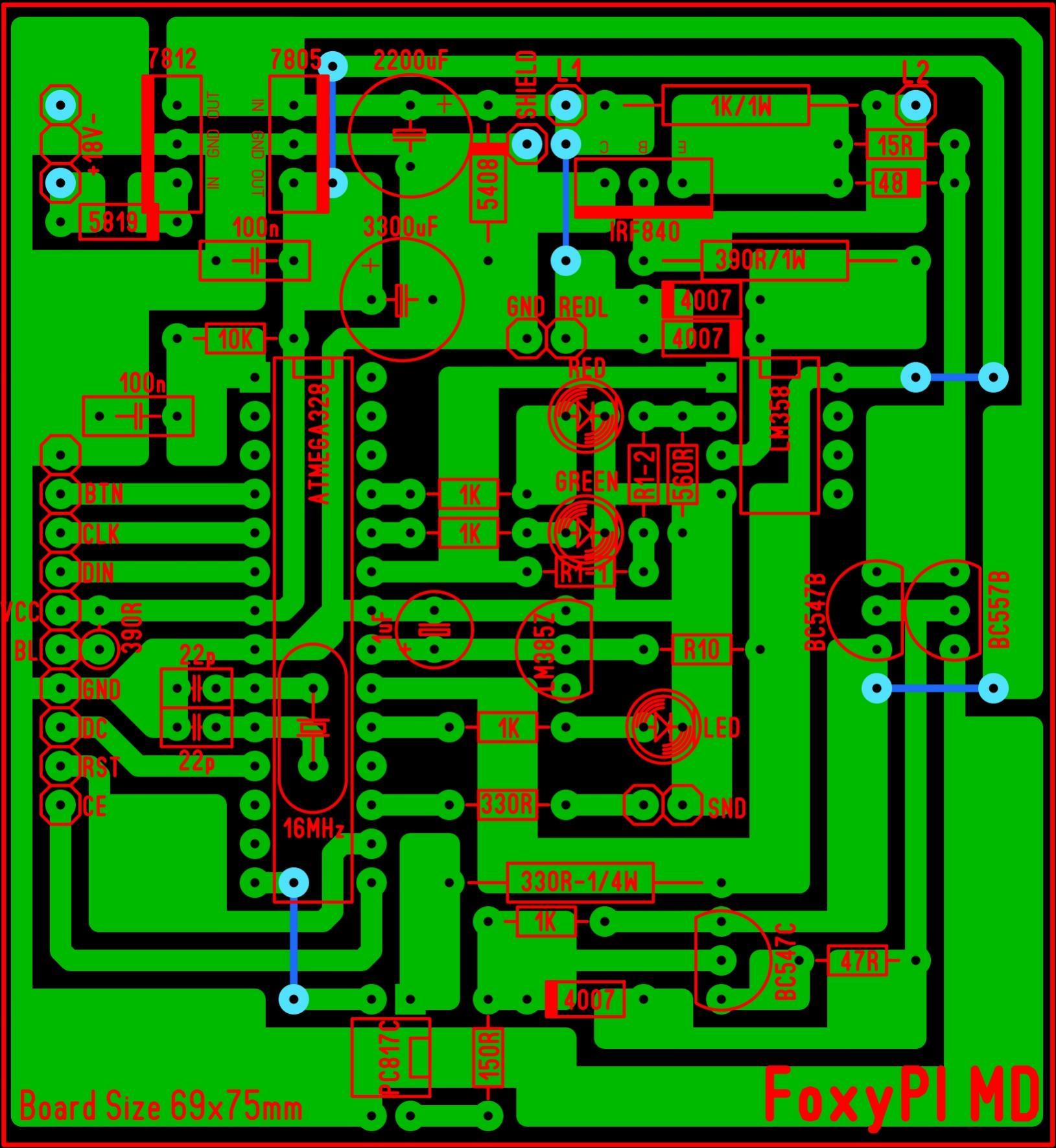

  • @BernteOne,,,Thank you for the 'New' Sprint layout tuition! This Forum is great that it has helpful people like yourself,,,I'm working on a few projects that I know will be of use for other members of Geotech in the future,,,It will be a nice feeling when I know that I have finally contributed something of my own as a thank you to the Forum for all the knowledge I have learnt on Geotech. I will start to re-draw the Foxy MD later tonight and I'll post it for you to check at your convenience. Thanks again for your time and patience, Regards, Marty.
    • @BernteOne,,,,Can you check this drawing for me please? Have I placed the Capacitors at the correct polarity? If the drawing has no errors I will try to make the board smaller. Thanks, Regards, Marty.
      • i can do this evening
        after this weekend it is better load jpg screenshot here so i can see it from mobile phone
        i am on holiday and will not take the laptop with me
        • Thanks. I need to know if I have oriented the capacitors the correct way because it doesnt show the polarity on the bmp image. Thanks, Marty
          • the sprint layout design you do seems ok
            cant find the problem you mean
            electrolytic caps with +/- are right direction
            non electrolytic are equal in direction
            • Thanks BernteOne,,I didn't know if I placed the electrolytics correctly or not. Is this size pcb ok or shall I make it smaller? Thanks, Marty
              • Check the grounds using the test probe. You have a couple of tracks with zero clearance.
                The FET is also shorted.
