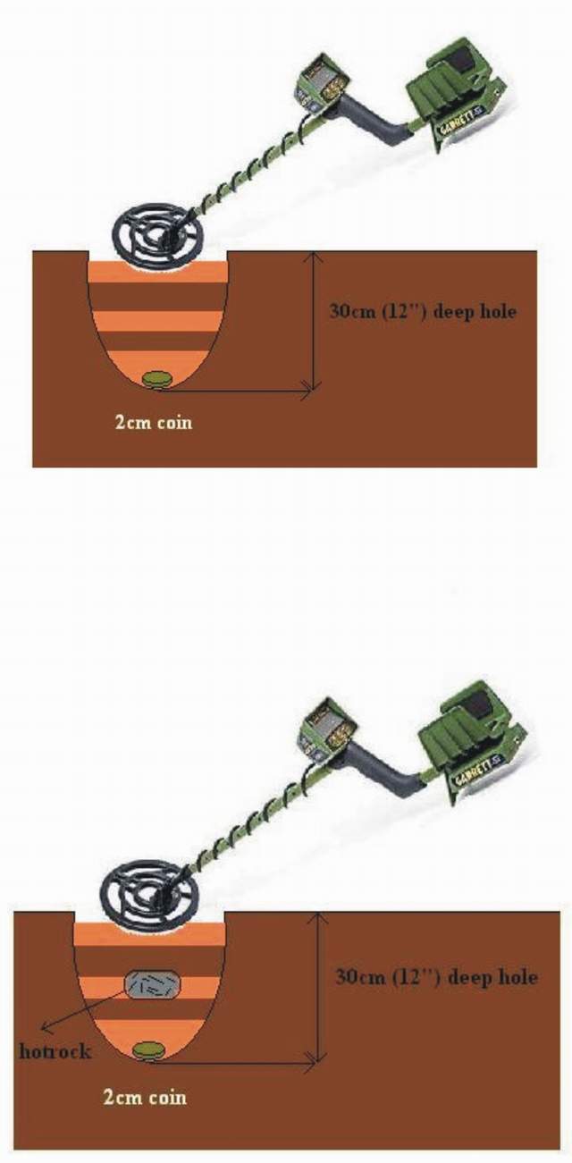

    Few days ago i checked a bit different thing;
    i dug a hole 30cm deep. At the bottom i put 2cm bronze coin and than returned all the soil over it. So coin was "burried".
    I took several detectors and tried to detect that coin.
    Most of the detectors really detected that coin. Some of the machines detected it barely, some other more easier, with louder and clear audio response.
    I am proud to say that my latest IGSL detected it as a piece of cake! Also my old SMW2 detected it pretty easy.
    I also checked with Musketeer XS and 18cm coil (TS800). Weak detection, coil must be almost pushed to soil... but still detected!
    Ok... that test was done. What was achieved with such test? Nothing really!
    BUT! Keep reading this!
    Next thing i done - i removed first 15cm of soil from a hole. Than i put piece of hotrock in it and again returned the rest of soil back.
    Pay attention on this! Hotrock is NOT just near the coin - it is 15cm over the coin and 15cm under the soil level, covered with soil too (buried).
    So... i took first of the machines to test. NOTHING! NO DETECTION AT ALL! Second detector... NOTHING! Third detector .. NOTHING.... !
    I took 8 various metal detectors and tried.... NOTHING! NO DETECTION AT ALL!
    Next 2 days i took 3 more metal detectors from a friends (XP GMP, DFX, Tejon) ... NOTHING!!!!
    So.... folks.... what are we talking about here all the time? Depths? Mha,mha,mha!!!!
    But wait! There is a hope! Minelab GP3000 DID IT!!!! Nice and clear DETECTION!!! With or without that damn hotrock - same DETECTION!
    VLF's are definitely very LIMITED!
    I can only wander... God knows how many gold coins i've been skipped so far in last 23 years of me being the prospector!??
    And most of those nice gold coins were "deep" barely 5-10cm in soil!
    So....
    We have to put the finger on our heads and start to think; are we gonna chase more (only) depths... or we gonna finally make some REAL WORKING VLF!?
    Just to be sure; read carefully what i wrote above! Hotrock IS NOT close to coin! It is constrained from a coin, in soil.
    Because when hotrock is indeed close to coin (over or under the coin) - than all better detectors DO DETECT coin easily.
    So please do not confuse and mix those two situations!

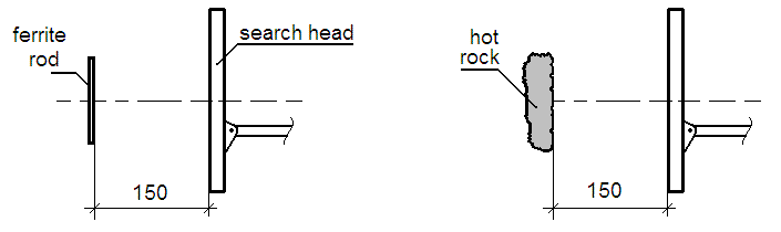

        I want to know if your hot rock is bad or not. Make AIR test with a ferrite rod and your hot rock. Adjust a VLF metal detector to eliminate (balance) the signal from a moving ferrite rod at distance 15 cm. Then test what response creates the movement of hot rock at such distance - positive, negative or none.

          It's the one i am keeping in my workshop for some time.
          This one:
          http://www.youtube.com/watch?v=_Zf3GsrSlDg
          and here:
          http://www.youtube.com/watch?v=7KGhjhYyVIs
          When GEB adjusted to fully reject this hotrock - ferrite rod is still a bit detected.
          So, when GEB adjusted to reject ferrite rod - this hotrock is also not detected. Answer is response=none.

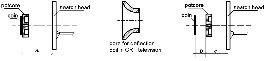

            STRONGER COIN SHIELDING THAN HOT ROCK
            Have someone tested coin shielding with large ferrite core instead hot rock?
              TGSL doesnt detect coin together with ferrite rod. I dont know about ferrite core in your drawing

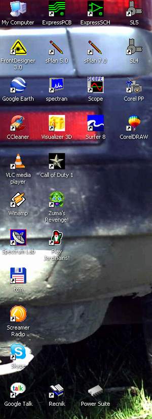

                      Depends of a task you are targeting... sometimes Paint(brush) is quite enough.
                      But sometimes you will need something better.
                      Most of the time i am using Corel Photo Paint 9. Very best!
                      Usually i do prepare some simple "objects" in Paint(brush), shape them in Corel Photo Paint and finalize all in Corel Draw.
                      Sometimes i even use Sprint Layout to draw some precise primitives!
                      Also lately i am using sPlan 7.0 and Front Designer 3.0
                      I am to lazy to "design" new objects, so usually am mixing various software and take various elements from each one, to finally get desired document.
                      Maybe is better that way? For me is better for sure!
                      So... it's just personal choice and habits..
                            Really hot rocks have magnetic response (natural or produced by MD impulse), so we need for test magneto-ceramic ferrite to simulate really hot rock. For your safety use strontium ferrite not barium ferrite. And uncoated / non-metalized.
                              This is true. Hotrock from my video clips is having noticeable magnetic features. When i test it with some permanent magnet - it is attracted. I have now 2 different types of hotrocks. The one i showed few times on video clips... and another one with a bit stronger magnetic features than first one. Second one i just got. In next video clips i intend to test and show both. By now, preliminary, i tested them with coins. Usually coin is easy detected when is placed under first one, but barely ...or not detected at all when placed under the seconnd one. Also second one is stronger attracted to permanent magnet than first one...
